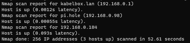

i have run nmap and this is what i got. the one additional device is my android device.
