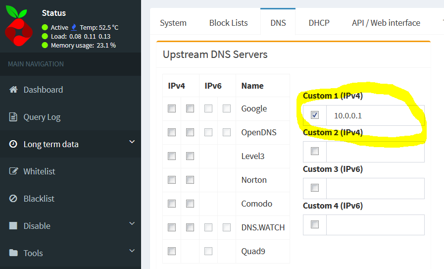

  • how could i maybe change dns upstream server from a google dns server to another one?
