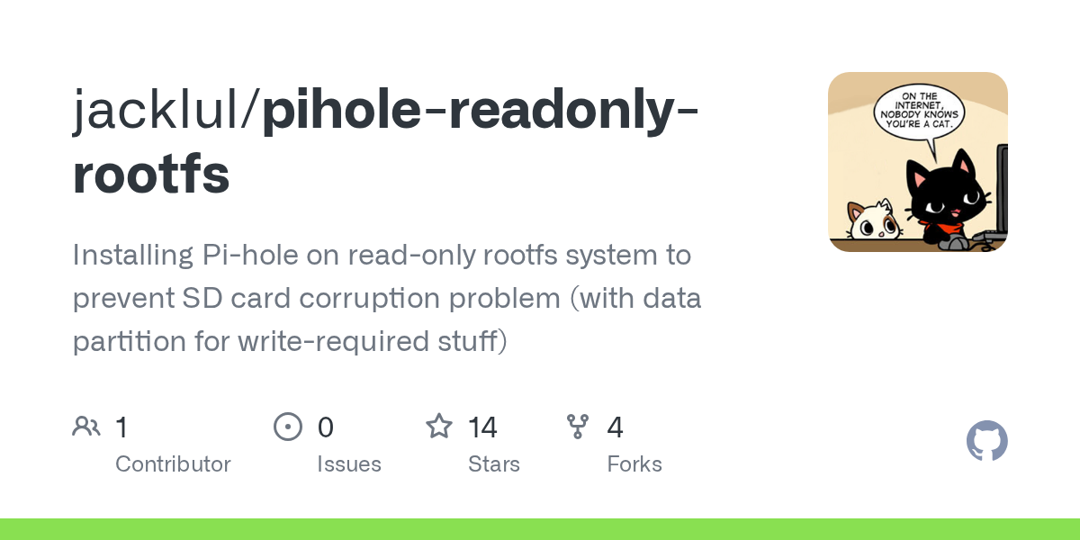

I must say that I have done some tweaks to have it (almost) in read-only mode, following this
So, some RAM is already used for the OS. Although it doesn’t seem too much. Here is the output of ‘free -m’
total used free shared buff/cache available
Mem: 176 39 83 5 52 83
Swap: 0 0 0

Below bit on Github is wrong/old:
sudo nano /boot/config.txt
# Reduce memory reserved for GPU
gpu_mem=16
Or are you still running Buster/Bullseye?
On my Pi with Pi-OS 12 Bookworm, that file explicitly says:
$ head /boot/config.txt
DO NOT EDIT THIS FILE
The file you are looking for has moved to /boot/firmware/config.txt

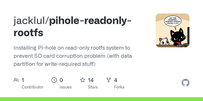

In the posted read-only guide there is an extra setting for the watchdog.
RuntimeWatchdogSec=15
RebootWatchdogSec=5min
ShutdownWatchdogSec=5min
I suppose this is what reboots the device when it hangs building the tree. Have to check some system logs.
