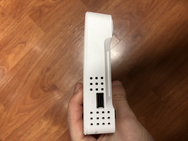

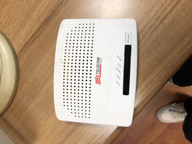

Hi! I wanted to know if I could use this old router as Pihole, instead of having to buy a Pi!
Thanks
No you can't - this thing has likely something like 4 or 8MB of RAM and 16 MB of flash memory.
If you are very lucky, you can install OpenWRT, and then use an Adblock-plugin. But mostly likely waste of time.
