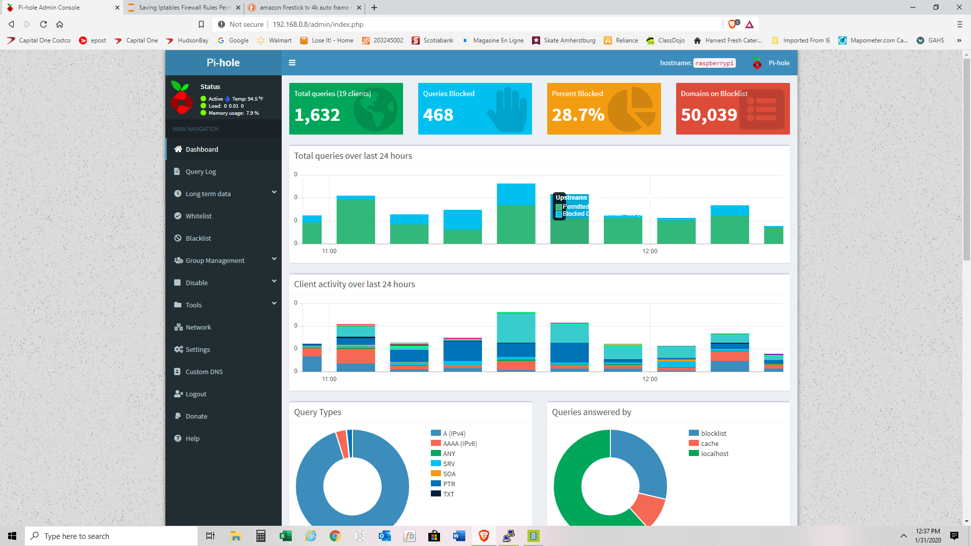

2 Things, first, the text is white on a white background on the bar graph as seen below. I cleared the logs to make it more apparent.
And second, the percentage of blocked is in relation to permitted queries as opposed to the total queries.

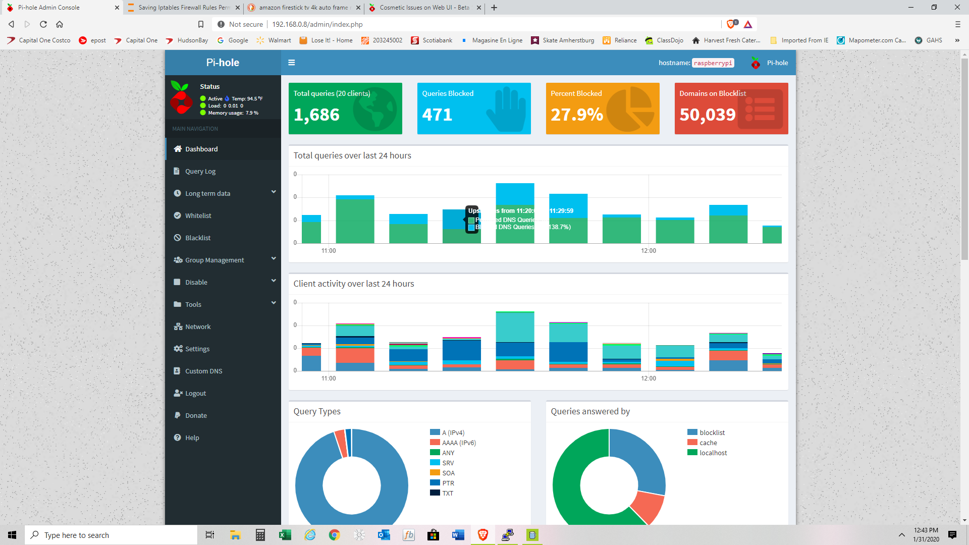

Which browser do you use? It may not fully support all the features. Can you check with a more widely spread browser like, maybe, Firefox or Chrome?
Thanks, this will be fixed by
Brave Browser is the one exhibiting the issue. Both chrome and safari are correct. Sorry, I meant to edit this post for that discovery. Otherwise, things are working quite well for my particular setup...thanks
This seems to be an issue inside Brave browser and is independent of Pi-hole, see, e.g., here
I assumed it was specific to Brave. Just forgot to clarify that chrome and safari were unaffected.
The mentioned bugfix has been merged into the beta branch.
