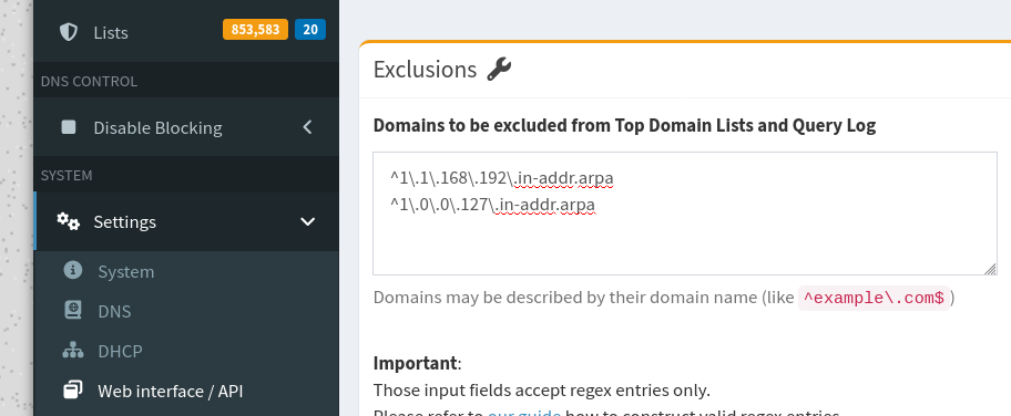

It is possible to block the reverse lookups from showing up in the query log, and top permitted domains of the web ui.
Enter the addresses into "Domains to be excluded from Top Domain Lists and Query Log" in the Web Interface / API settings page.
Alternatively if you would like to disable the display of all reverse queries, you may enter
in-addr\.arpa
to the same location.
