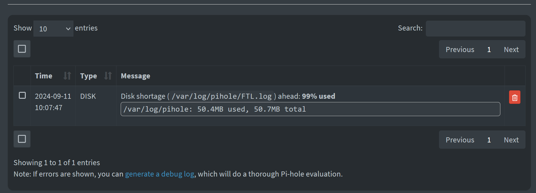

Constantly getting a log full error
Hello.
I have used pihole for a couple of years now and have nothing but good things to say about it.
But there is a constant problem that I can't seem to be resolved.
My logs get full all the time.
I have disabled logs and changed the FTL log behaviour to rotate and keep only 1 day. Yet I still get this annoying error.
Could someone please help me change my settings so I won't get bugged by this message?

Your debug log shows that you are using zram to mount /var/log, and have assigned just 49M of RAM for its storage:
*** [ DIAGNOSING ]: Disk usage
   udev            421M     0  421M   0% /dev
   tmpfs            99M  856K   98M   1% /run
   /dev/mmcblk1p1   29G  1.9G   27G   7% /
   tmpfs           493M  5.4M  487M   2% /dev/shm
   tmpfs           5.0M  4.0K  5.0M   1% /run/lock
   tmpfs           493M  4.0K  493M   1% /tmp
   /dev/zram1       49M   28M   18M  62% /var/log
   log2ram         128M   93M   36M  73% /var/log.hdd
28M of that are already used, and according to your ls output, Pi-hole is merely taking up some 41K of it.
When your log space is full, it's quite kely that Pi-hole is just reporting storage exhaustion, not necessarily because Pi-hole's logs themselves would contribute substantially.
You should either increase your zram storage, or mount /var/log on your sd card.
