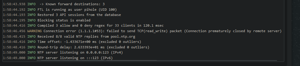

"Connection error (1.1.1.1#53): failed to send TCP(read_write) packet (Connection prematurely closed by remote server)"
the past days/week(s) im getting this "error". DNS Resolution still works, but i see this Warning/Error on my Dashboard always and it annoys me:

Despite the annoyance, this warning shows that communication with your specified upstream server wasn't possible. If this happens once, it may be irrelevant, if you have multiple TCP-capable upstream DNS servers, Pi-hole will try the next one. If not, the name resolution will fails and your client will (hopefully) retry the query. If, however, this happens more often, you may want to know about this and be able to intervene, e.g., by changing over to a "better" upstream server.

Not necessarily. The warning your are quoting means connection has been established but the data transmission was not finished but instead, the connection was prematurely closed by the remote server. Most often, this comes from (very!) brief Internet connections outages. Out of interest, I set up a very tight connection monitoring between myself (FTTH) and three high-availability servers on the web and have been able to find hundreds of short outages throughout a day. They only last for less than a second each so us, human beings, we probably simply don't realize this at all in our daily lives. Maybe you see this once a week by chance that a webpage takes 0.5 seconds longer to load than usual and don't really realize what this means. The page eventually load as your browser will retry.

If it happens to any server, the "issue" most surely is within your own Internet connection. I have been searching through my most recent 4 days of logs and cannot find a single occurrence of this error in my own network - overall, I don't think this is a Pi-hole issue. The code doing this has always been there, just the reporting to the user is new.
What may be of interest to further debug this is:
  1. Why does it only affect TCP queries? (usually, DNS is UDP)
  2. Is it always the same client making the query?
  3. Is it always for the same domain / query type?
