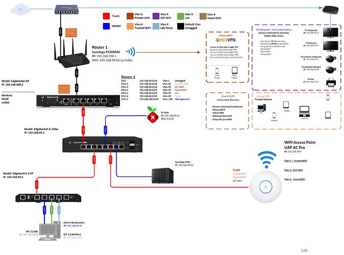

Please make a sketch of your network setup and post it here. That will help us understand your configuration.
Here is the basic cleaned up network diagram of what i have. The problem being that anything connected to Router 1 does not make use of Pi-Hole, while everything behind router 2 does.
Ping connectivity exists between the two routers and their respective networks
Ports 53 TCP & UDP for DNS.
Port 80 TCP for the HTTP admin page.

On Router2, These need to be port forwarded to the IP of Pi-hole.
Everything in the Router1 LAN segment will need to address the Router2 WAN IP on relevant ports to get to Pi-hole.
Ps. you wont see individual stats for the Router1 WiFi clients as from Pi-hole point of view, all queries originate from the Router2 LAN IP.
Worked like a charm. I totally neglected that it would require port forwarding. But forwarding them to the PI-hole IP and then setting Router 1 Lan DNS to point to the Wan interface of router 2 did the trick.
