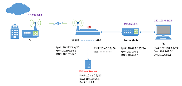

I am trying to get pi-hole configured on a rpi running Parrot OS that is being used as a range extender connected to a public AP.
It is currently configured to forward ipv4 from Wlan0 to eth0 providing internet access to my internal network.
The internet is currently accessible from the internal network and Ads are being blocked as expected when running pi-hole on eth0.
My problem is that i am unable to access the pi-hole interace from either the rpi or PC1.
The services dnsmaq and lighttpd fail to start which is why im confused adblocking is working on the internal network.
here is a diagram of my current setup.
can someone confirm i have my addressing configured correctly?

EDIT: Added Subnets to diagram

Subnets aren't displayed in the drawing.
Does the Pi-hole box have a route to the 10.192.64.1 gateway if not on same subnet ?

EDIT: The drawing is confusing me a bit.
Are the "Rpi" and "Pi-Hole Service" symbols one and the same box ?
If so, why does it have two IP adresses 10.42.0.1 & 10.42.0.2 in the same subnet ?
@deHakkelaar Yes pi-hole is running on the rpi, the rpi is just forwarding the traffic from wlan0 to eth0.
Im currently a student so still learning. I have update the diagram with subnets for you.
im not sure i have the pihole address configured correctly.
I wasnt sure wether to have an ip assigned to it on the /20 or /24 subnet. I was trying to avoid having an ip assigned to the server that caused a conflict with the DHCP ips assigned by the AP.
pi-hole is currently sinkholing ads before they reach my internal network however, if i browse from the pii, adds are let through. I assume this is because i configure pi-hole to run on eth0. should i be running it on Wlan0 instead?
