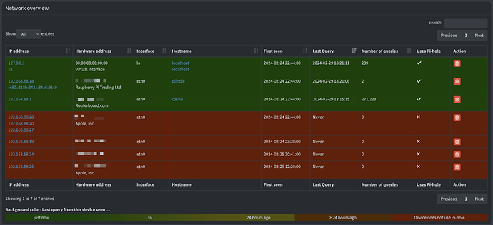

I should see my client list in the network tab instead of my routers doing all the requests. if not how can I control each persons permission ?
Only my router show up.

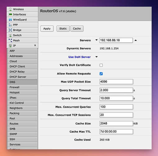

From what I understand then users should use directly my pi-hole has them DNS so I have to configure every machine ? Is there a way I will not have to configure every machine?

That will be the case once you configured your router to tell its DHCP clients to use Pi-hole for DNS.
As you are currently only seeing your router in Pi-hole, that would suggest that the screenshot you shared shows your router's upstream configuration, i.e. the DNS server that your router will use.
See also Making your network take advantage of Pi-hole.
Yes the Router use the Pi-Hole has upstream DNS, i'm searching now how to let PiHole manage the DHCP now. Thanks
I don't use a Mikrotik, but maybe you can configure its DHCP server to advertise Pi-hole as DNS server.
Read the Configuring IP Access section from help.mikrotik.com.
It's quite possible that you won't need that.
Did you inspect the available DNS settings for your Microtik's DHCP Server directly above DNS yet?
