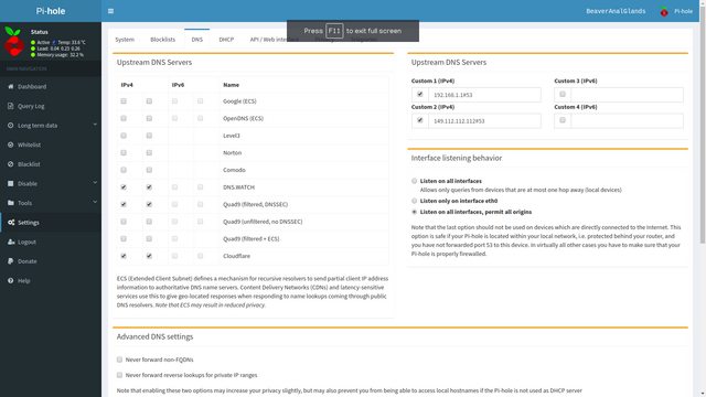

I use a DNS Proxy as my upstream DNS, as this is used to unblock regionally locked tv streams. This is all working fine for me, my router points to the pi-hole that then points to the dns proxy, and all works well. My one issue is that for local content it still goes through the dns proxy unneccesarily, and this can cause 10-15 minute outages when my ISP changes my IP (i'm on crappy VDSL).
The jyst of my question is, is it possible to conditioanlly forward the upstream requests ? i.e. can I get certain local domains like tvnz.co.nz for example to forward to my ISP's DNS or cloudflare or whatever, and the rest to get sent to the DNS proxy for resolution ?
Yes, though you'll need to manually configure that, the conditional forwarding set by the web interface defaults to using the upstream/router IP address provided. Same concept though, a config file in /etc/dnsmasq.d/ with the conditionally forwarded domains and the IP address of the upstream server to query.

So I'd need something like server=/tvnz.co.nz/1.1.1.1 ? Can I use wildcards/regex in the tvnz.co.nz bit ? Is there doumentation on this setup ?
