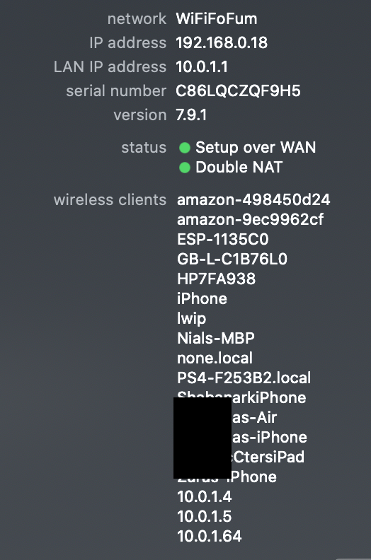

Here is a screenshot of the dashboard in my router showing that it does know the names for clients (some names are blurred for privacy)
but then it won't tell us:
If the router does not respond with the host names to such requests, it is a bug of the router and Pi-hole can, unfortunately, not do anything about it.
