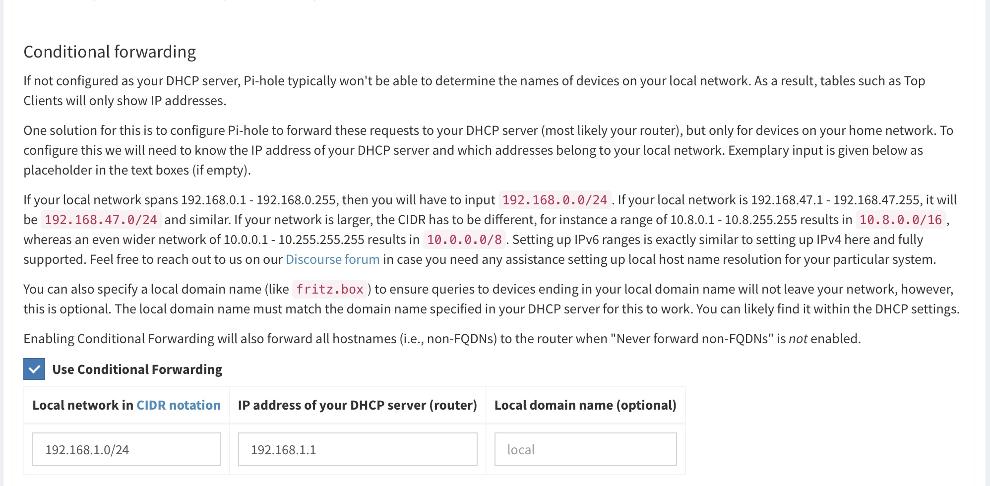

My Conditional Forwarding configuration:

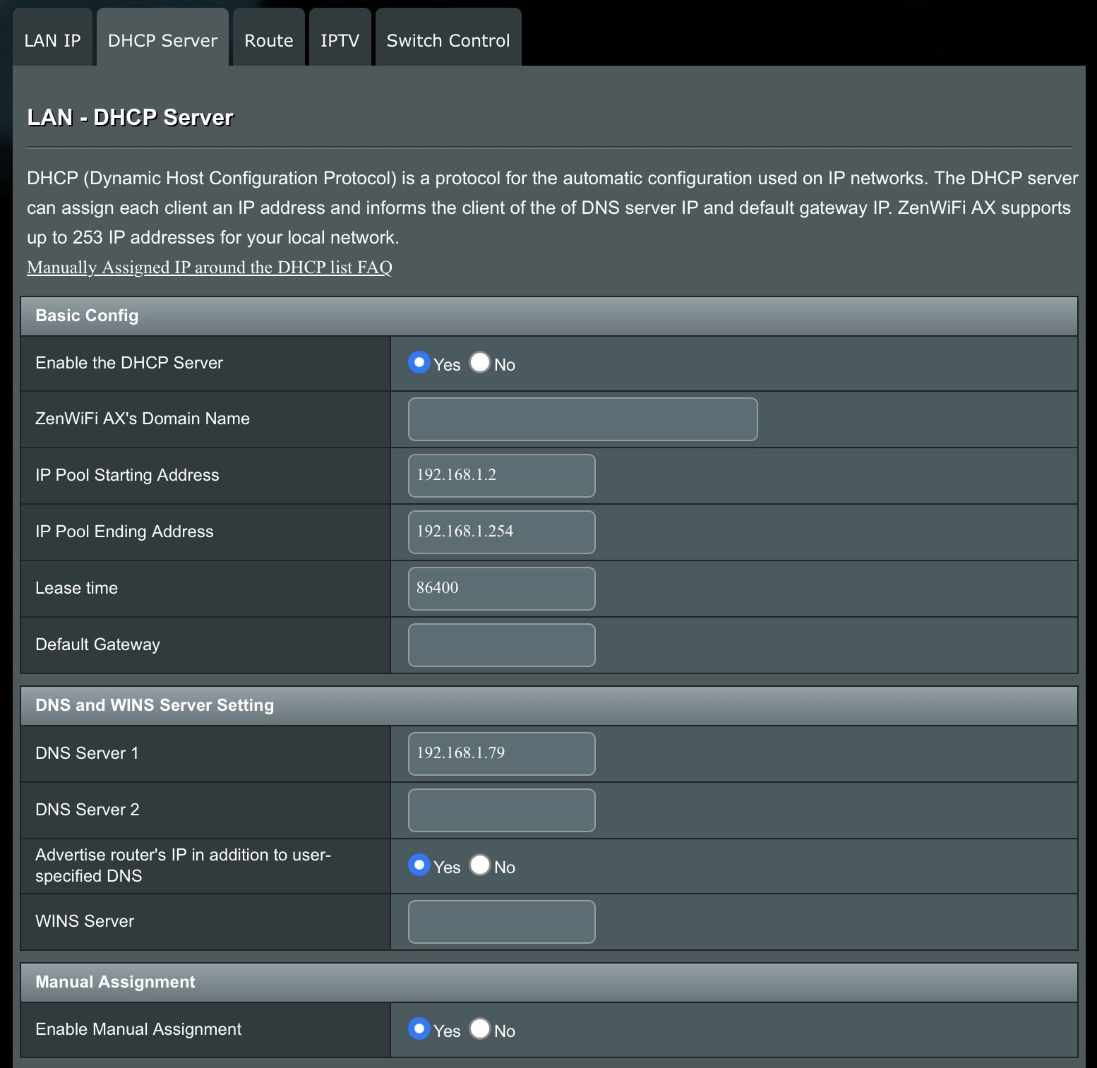

My router DHCP configuration:

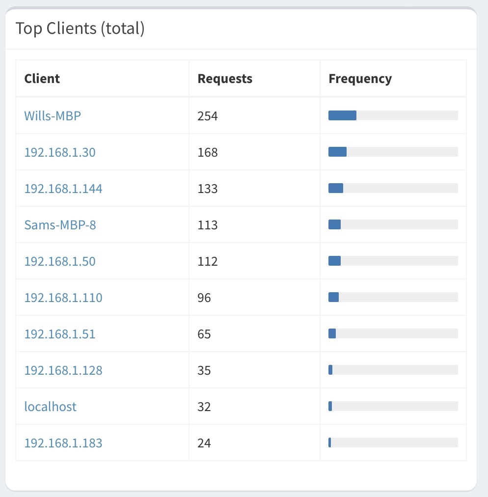

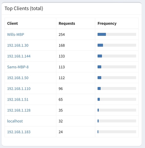

Resulting client list in Pi-hole web portal (only two client names resolved):

To add to this. A bit of trial and error has shown that there are (at least) two issues that might be causing this.
  1. Some clients names include spaces in their names within the router’s DHCP server. Removing spaces seems to allow pi-hole to recognise their names.
  2. Quite a few devices on the network are iOS devices. There is a wi-fi setting called ‘Private Wi-Fi address’ which when activated, seems to prevent the device name being recognised in pi-hole. Is there a way I can manually bind these ios device names in pi-hole?
Those nslookup results from directly querying your router at 192.168.1.1 confirm that Pi-hole's Conditional Forwarding is working correctly - it is your router that is supplying those answers, and Pi-hole's dashboard merely reflects this.
You'd have to address this at your router.
If you can't fix this at your router, you could consider to create the respective Local DNS Records via Pi-hole's UI.
Note that this approach would still require your router to play along and assign the same IP addresses to the same devices.
For any devices randomising their MAC address, make sure that such a device does support using the same randomised MAC for a specific network, or to not randomise its MAC for a specific network or not at all.
