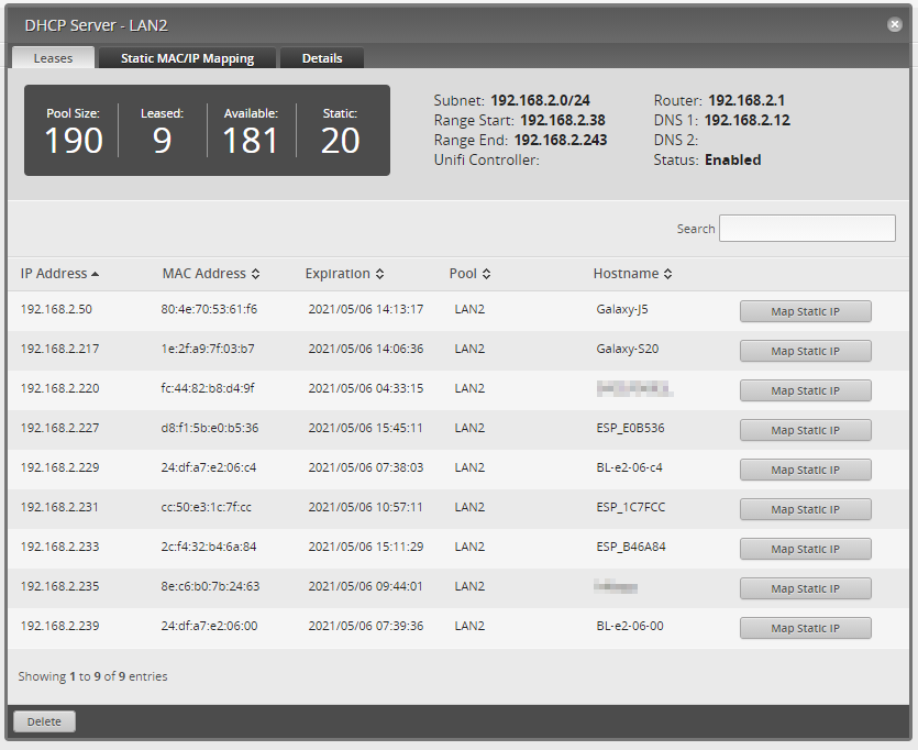

That's my router. When logging in to it, it shows all local IPs and hostnames.
From other machines, I could input the hostname directly, for example my Unraid server has a hostname of "Tower" and I can go to the browser from another machine and type in "Tower" and it would take me to the server's webpage.
Here's a screenshot from the router's DHCP (some hostnames have been obfuscated intentionally):
The router at 192.168.2.1 (the only one, actually) does know the answer - but maybe there's something I need to configure on it, specifically for Pi-Hole?

Seeing that you are using Ubiquiti routing equipment, this likely fails due to lack of appropriate DNS record creation on DHCP lease registration, i.e. your router cannot answer the corresponding DNS requests (just as demonstrated by you executing Dan's earlier dig command).
Some Ubiquiti models would be able to mitigate this by switching the on-device DHCP server to dnsmasq .
You'd have to consult with Ubiquiti support whether your router would support that and how to enable it.
In case that's not possible, you can still create Local DNS records for your IP addresses in Pi-hole.
Obviously, this will only be a viable option if your devices are assigned with a fixed IP address.
