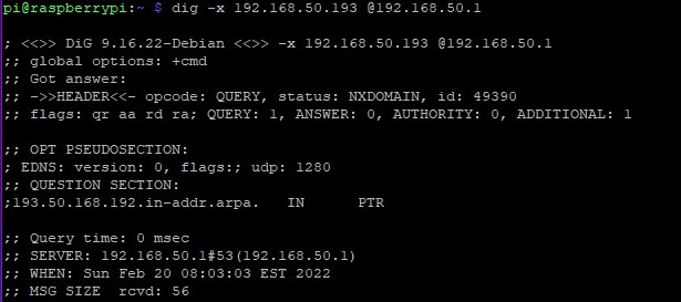

Please post the output of
dig -x 192.168.50.193 @192.168.50.1

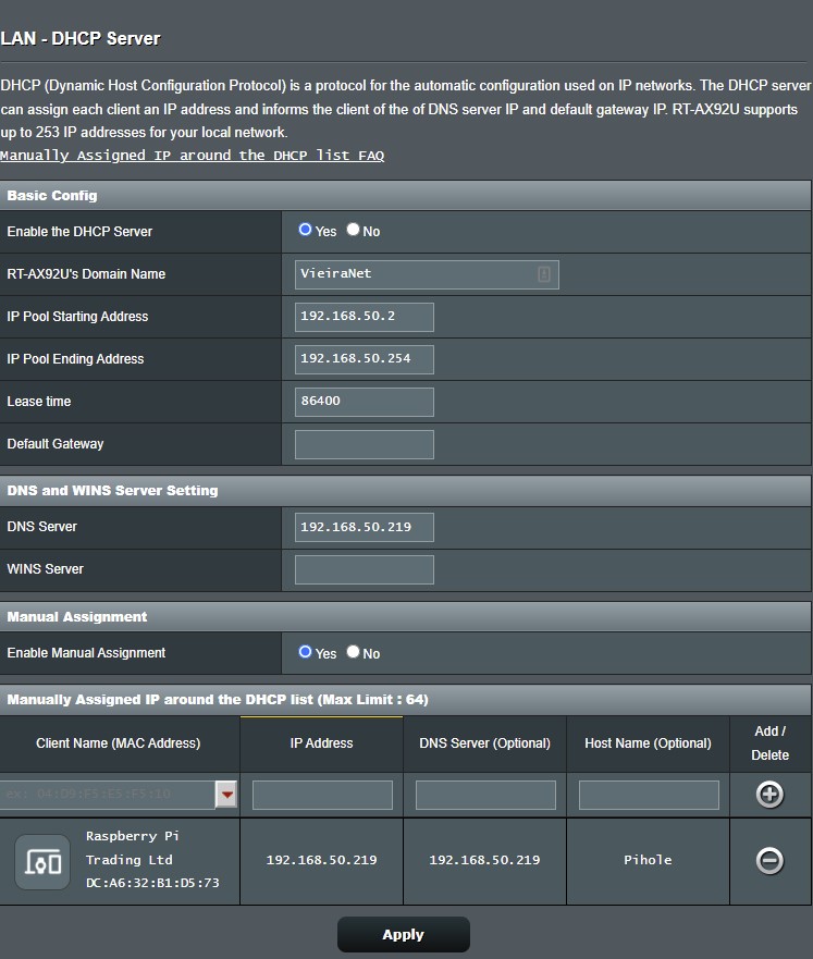

LAN Config:

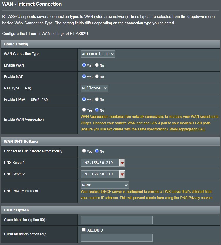

WAN Config:
DIG Output:
As I thought:
  1. Your router doesn't know the hostname of 192.168.50.103
  2. For unknown Hostnames you configures a loop. Pi-hole is sending the requests via conditional forwarding to your router, which can't answer them and sends them further upstreams, via it's WAN DNS server. This is again Pi-hole. This is creating a loop.
Removing the WAN settings and applying conditional forwarding again seems to have corrected the issue.
REMOVED
HOWEVER, turning that off allows the router to bypass the pihole. And use non-open-DNS. This also means it bypasses my content filters setup in the piHole.
