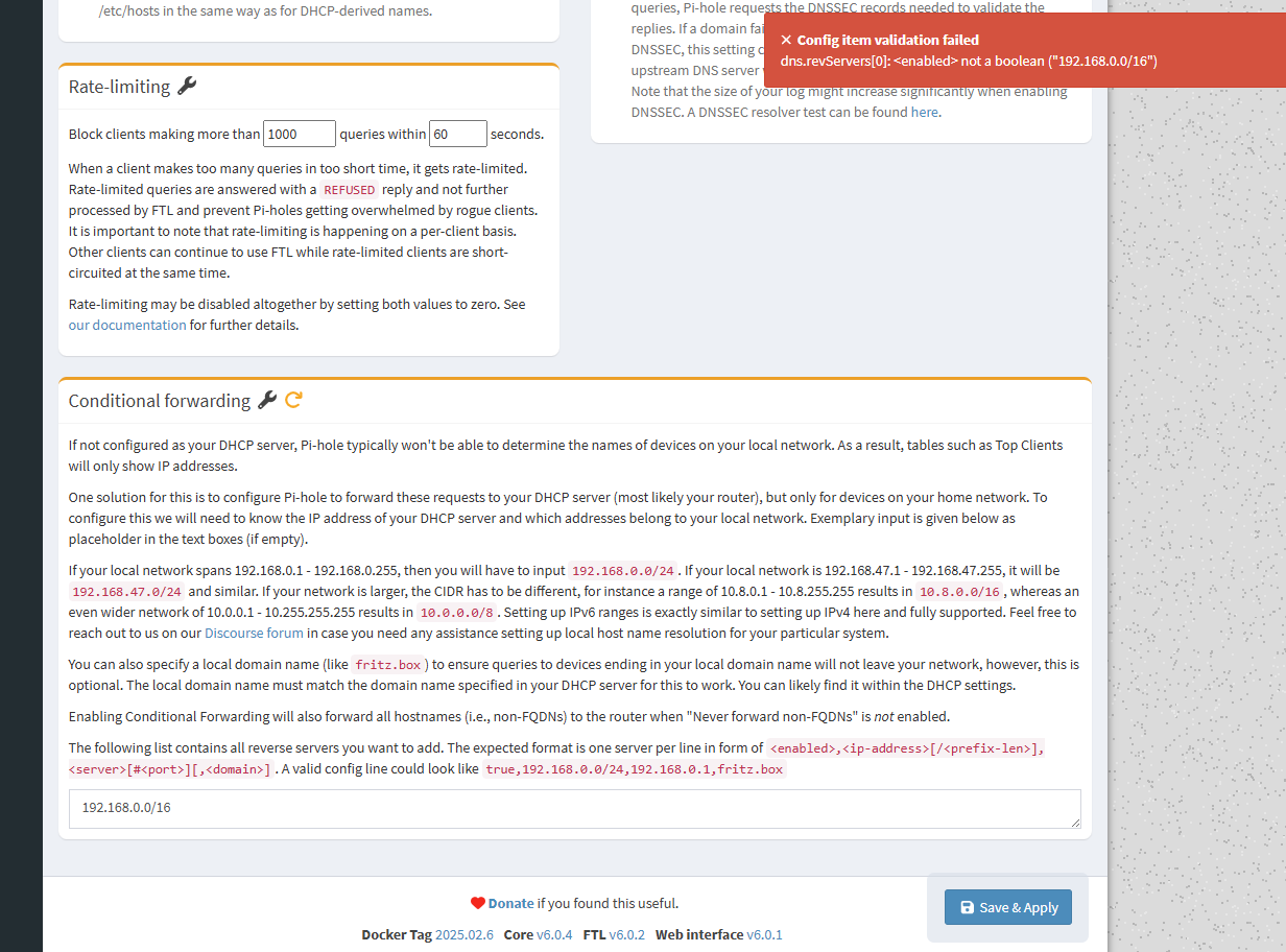

I have a UDM SE acting as my DHCP server, and I currently have pihole acting as my DNS server running on unRAID 7.0.0 as a Docker Container. I'd like to keep the UDM SE as my DHCP server, but would like the pihole to be able to get my device names from the UDM SE. I've tried to research this, and it looks like Conditional Forwarding is what I need working on the pihole.

It never successfully applied because I think I am entering the format incorrectly, or am missing information. On the pihole DNS Settings, I went to Conditional Forwarding and typed in 192.168.0.0/16. Clicking 'Save & Apply' gave me a dns error (see attachment).

Things have changed with the update to v6, but I believe it should be:
true,192.168.0.0/16,<dhcp server ip>,<local domain name>
Thanks for the reply and direction on this. I'll give that a shot.

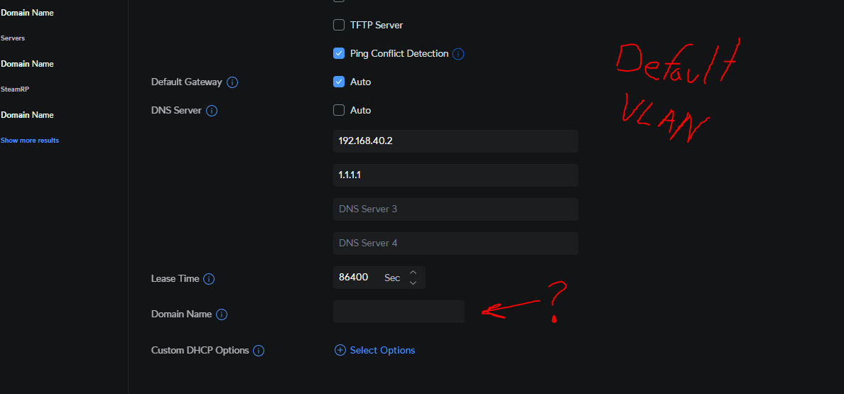

Not to get too far off-topic, but for the local domain name, I would be using whatever is listed in my UDM SE, correct? I saw that pihole and the UDM SE both have domain sections; so I wasn't sure which. If it is the UDM SE, I have a Domain option for each VLAN I created but they are blank.
I do own a domain, so wondering if I can just use that, like, iot.registereddomainname.com and cameras.registereddomainname.com.
Attaching screenshots.
