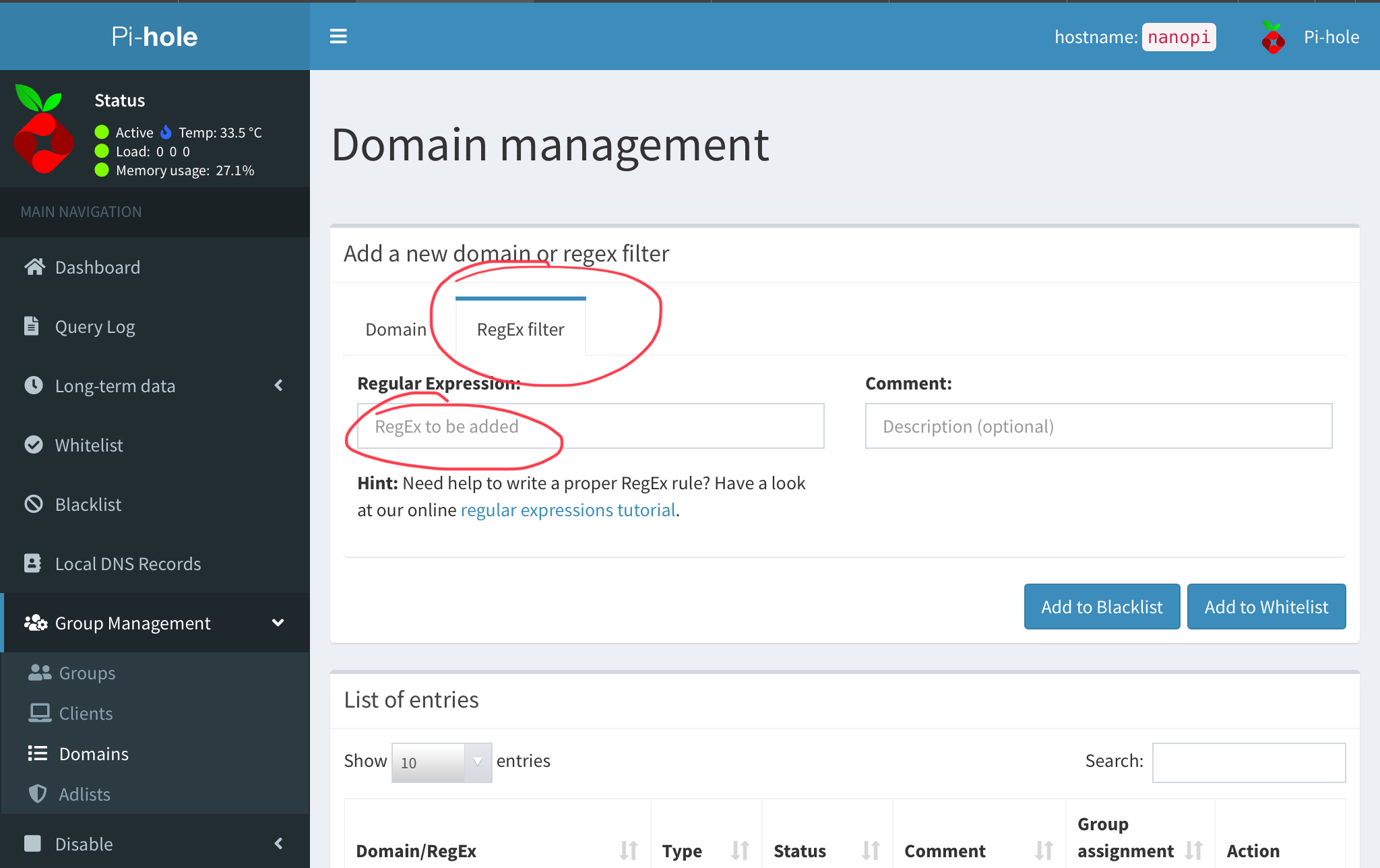

This has to be added specifically as a regex, and not as a blacklist entry. It's not a domain and will cause this error if you try to add it as one.
Yeah, that's the screen giving me the error ...

You are definitely entering the expression as a regex, and not as a domain?
Yeah definitely, although it's giving me other errors now... if I try and delete a blacklist entry, the whole device hangs and I have to reboot...
