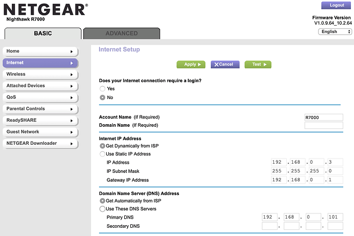

On the R7000, you should see something like this, with the Pi-Hole IP address listed as the Primary DNS, and similar to the modem's address under Gateway IP Address:
With that, you should be all set. DNS requests from your devices will go to the R7000 where they'll be filtered (or not) by Circle, and those not filtered will go to the Pi-Hole, and then to your upstream DNS providers.

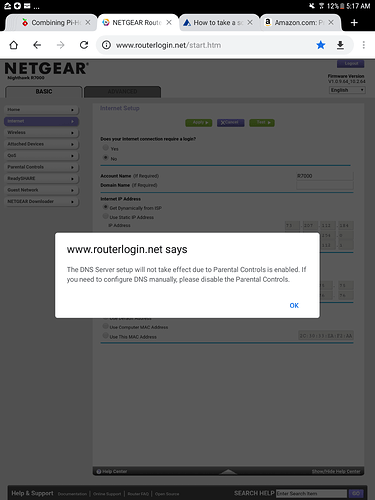

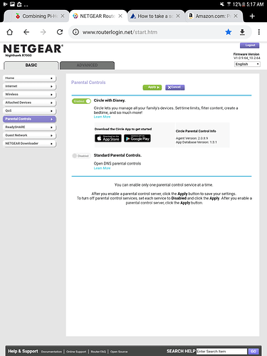

It's not letting me update the DNS address to PiHole IP in router screen. Error: The DNS server setup will not take effect due to parental control is enabled. If you need to configure DNS manually, please disable parental controls.
Disabling parental controls will disable the Circle too.

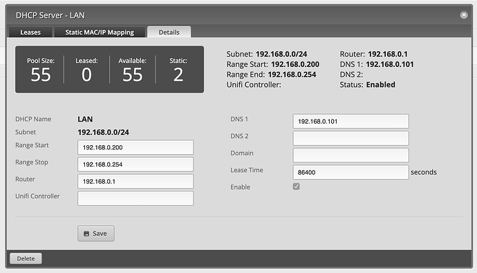

Yes, you need to set the DNS server in the DHCP settings on the modem, which will then push it down to the router. It should be in modem's settings somewhere, maybe under something like LAN.
When I try to enter DNS, it stops me with this error.
Yes, you need to set it up in the DHCP settings on the modem, rather than the router. The settings should look something like this:

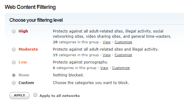

So no circle BUT, you can use OpenDNS' parental controls ... And they are pretty powerful too ...
Give them a look at:
Here are some of the options:
With some more options:
I personally gave up on the Circle path as this was a lot easier for me to set-up, assign and manage the OpenDNS option.
