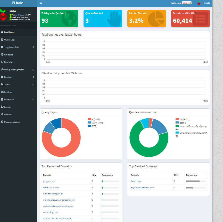

This is what I am seeing on the dashboard after the cold boot:
https://tricorder.pi-hole.net/r4i3eqcqs8

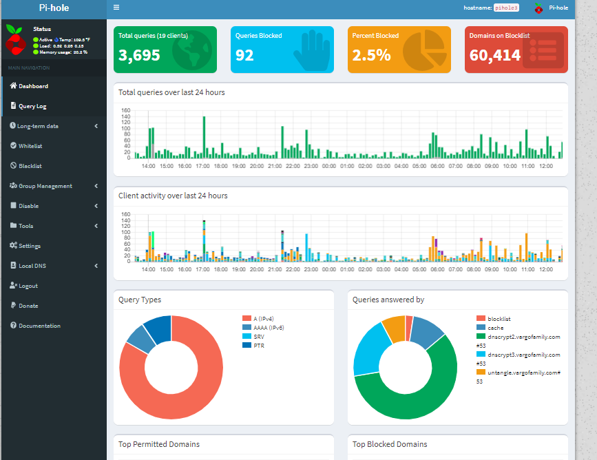

After a container restart everything looks fine:

Yes, if I do a boot of the Raspberry Pi the dashboard has no long term data for the last 24 hours displayed on the admin dashboard. After a boot I then do a container down and a container up and then the data does appear. After the boot and verified the dashboard issues I issued:
docker-compose down
Wait for the container to stop, then do the:
docker compose up -d
again and then all the data is there.
An alternative is to issue a container restart via Portainer.
