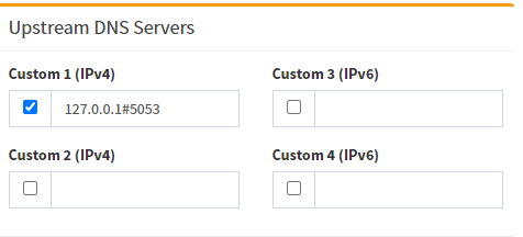

I'm thinking of installing cloudflared alongside Pihole is this worth it?
If I install it and enter 127.0.0.1#5053 in Custom1 (IPv4 upstream) will this mean IPv6 queries wont work or go unencrypted?

I don't think you will get the security benefits you expect but it is easy enough to install it and see if you are satisfied with the performance.
No. A or AAAA queries can be resolved fully by IPv4 only. You don't need an internal loooback IPV6 address specified.

If this is what you want, install Cloudflared. Note this won't hide where you browse, but it does prevent DNS interception and redirection by your ISP.

Cloudflared will handle the DNSSEC checking. If you enable this in Pi-hole, it will simply show the DNSSEC results in the query log.
