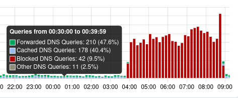

Well that solves that. I will have to look into why I have like 25 more clients now.

The other thing is the amount of device has basically doubled since I upgraded to v6, which also seems unusual. I am thinking I am just to a full reset and try again.

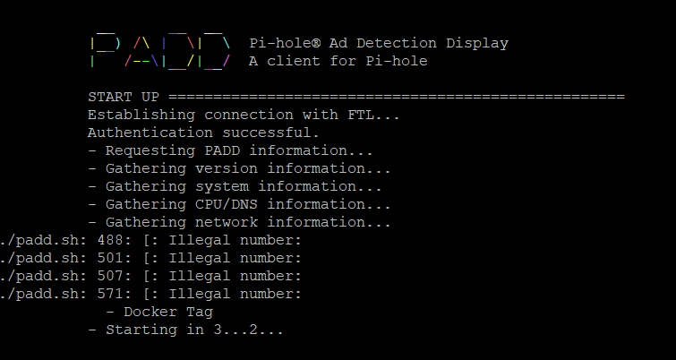

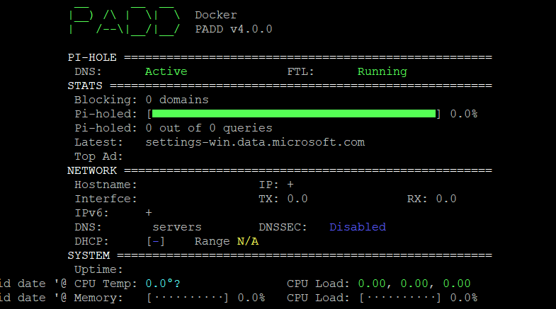

I downloaded the development branch (of padd.sh) on my RPI with Raspbian10 and Pihole v6.
But when padd.sh starts I see an error and the resulting dashboard only shows the last DNS request, but nothing else. What am I doing wrong?
Are you running PADD inside docker?
no, directly on my RPI. Sorry if that is a stupid question. Not really familiar with linux and docker stuff. Is it maybe as simple as to remove this "docker tag" somewhere?
The tags should not be there and we need to get to the core of the problem.
Please run bash -x ./padd.sh. It will generate a huge output. Please DM it to me.
Sent the output via DM (huge thx for you support btw).

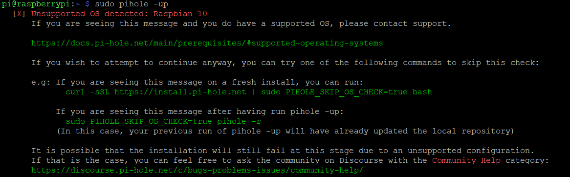

Last time I tried "pihole -up" I got the following message (DNS resolution was not working properly at that point, hence I initiated an update):
I then continued with the suggested command sudo PIHOLE_SKIP_OS_CHECK=true pihole -r
which restored DNS-functionality, but not "padd.sh" functionality (even after downloading the dev-branch).
EDIT: I also checked on the page mentioned in the error, and it seems Raspbian should still be supported, correct?
Raspbian is, but your version is too old. We support versions which also get support from their distributor. Raspbian 10 is EOL since mid 2024.
Then you should stop the update before doing any changes. I wake up today to an unusable network because of the night update
Yes, that's how it looked on my side initially too. No resolution was working anymore, but the "skip os check" fixed pi-hole. Will update my distro now and report back.
