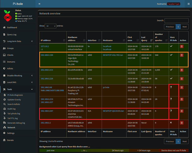

Some clients NOT using pihole? as seen in screenshot.

There is a legend on the bottom of the page explaining the different background colors:
The item marked in yellow used Pi-hole in the last 24h.
The items marked in red used Pi-hole before, but not in the last 24h. If you take a look at the "Last Query" column you will see these devices used Pi-hole yesterday, just a little over 24h ago. The devices are probably away from your network (or currently not in use).
The only item not using Pi-hole is the router (the last row).
I understand about the DHCP this is a problem as quoted above when i disable DHCP on the router i have NO internet. meaning no internet not being able to connect to pi-hole. :thinking:
I also understand the legend, also as highlited the AUSTec PC NOT using Pihole and it should as its always on and connected to the same router as my machine and the amazon firestick should also be using pihole?
