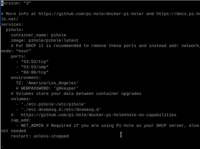

How is the docker networking configured? Would be helpful to see the docker-compose.yml or your docker run command to start the container.
DHCP is a broadcast mechanism and needs special configuration if you chose to run it in docker.

It appears to be my docker config. I'll look at the docs you shared.

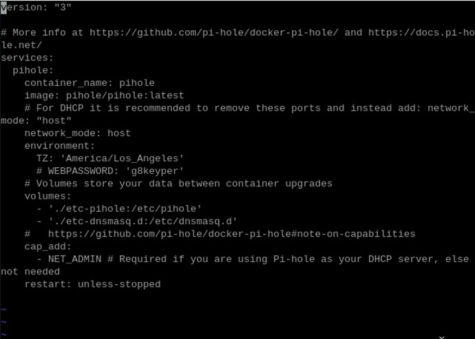

Updated my docker-compose.yml as follows. It's still not working, but I did not see anything in the docs about the NET_ADMIN line.
Ran docker-compose restart after updating docker-compose.yml
OK, I got it sorted.
I was missing quotes around "host" and docker-compose restart was not sufficient.
I fixed docker-compose.yml and then performed a docker-compose up -d
