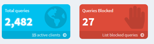

I installed PiHole on Synology using Container Manager, it runs OK but it does not retain historic data or clients.
When I look at the dashboard I do see 20-40 clients showing under Total Queries, when I go to " Client group management" I do not any client entry, nor I can add a client. The drop down list for known clients is empty. When PiHole is restarted all historic data is lost, charts are blank.
Privacy settings are set to "Show everything and record everything"

@eloHip - Did this resolve your issue of clients not showing up? I'm having the same trouble where clients sort of appear under Top Clients on the Dashboard - primarily it's just the FQDN of my router or static IP configured devices - no IP addresses show up in Top Clients like most people report. However, on the actual Clients page, nothing shows up at all and I have setup Conditional Forwarding. Like you, I cannot add clients on the Clients page either. I have noticed if my devices are configured to use a static IP - ON THE DEVICE - that it will show a FQDN for that device in Top Clients... but still nothing on the actual Clients page.
@rdwebdesign - Interestingly enough, I see my pihole-FTL.db file is exactly 44kb as well. I'm a complete noob here with Synology Container Manager (containers in general) and Pihole - but the sudo commands you recommend, is this something where I'd need to SSH into my container to execute these commands? I'm kinda missing this basic concept to get to a terminal window when Pihole is running in Container Manager (formerly Docker) on a Synology NAS. I do have a dedicated macvlan network for my Pihole setup so that I can access the Web interface on a static LAN IP. Would really like to figure out why I can't just see my clients on the dedicated Clients page - even though I can seem to make them show up on the Top Clients area - although I don't want to go to each device and configure it with a static connection. I will finally add that I do have IPs reserved for everything at my gateway... but that just means DHCP (from the modem/router) will issue the specified IP for the given device/mac.... the devices themselves still request their IP via DHCP though.

@rdwebdesign - Thank you for the fast reply. I did run these commands and to anyone else reading this, yes, you need to SSH into your Synology to get a command line interface in order to run the commands. I did run them with "sudo" at the beginning FYI.
I am now seeing the IP addresses listed in Settings - Network page as you mentioned - before this page was also blank. On the Clients page itself - the "Select Client" list is now populated whereas before it was blank. This has helped tremendously so thanks! Now I can start grouping and finetuning my ad blocking it appears. I am not seeing hostnames in the Select Client list - just IP addresses. I believe there are other posts on this issue I will need to read up on to see if it can show hostnames instead but I can live with IP addresses if necessary - thanks!
I spoke too soon :frowning: While I do see some clients, I only see about 10 clients of 40 that are connected to my network.Top Clients still only shows devices which have been configured with Static IPs at the device. I'm not sure why that would change the behavior within Pihole... but it's something I've noticed.
