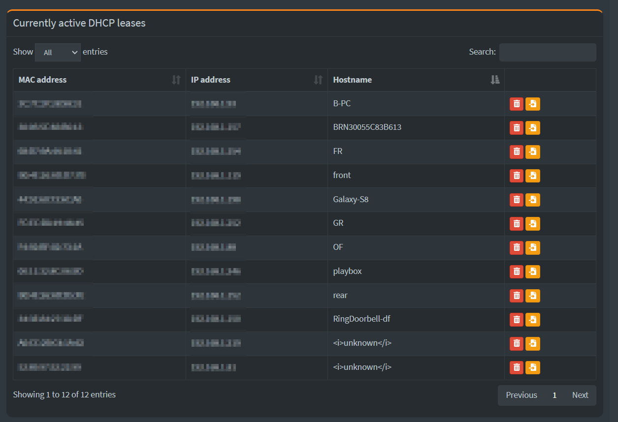

Local hostnames should resolve, and appear to resolve in DHCP settings:

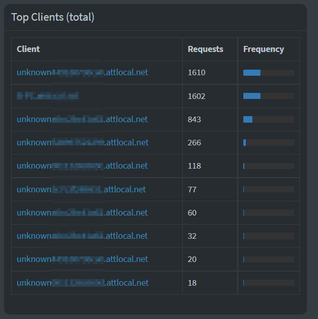

Local hostnames in Query log and Dashboard show "unknown.attlocal.net" :

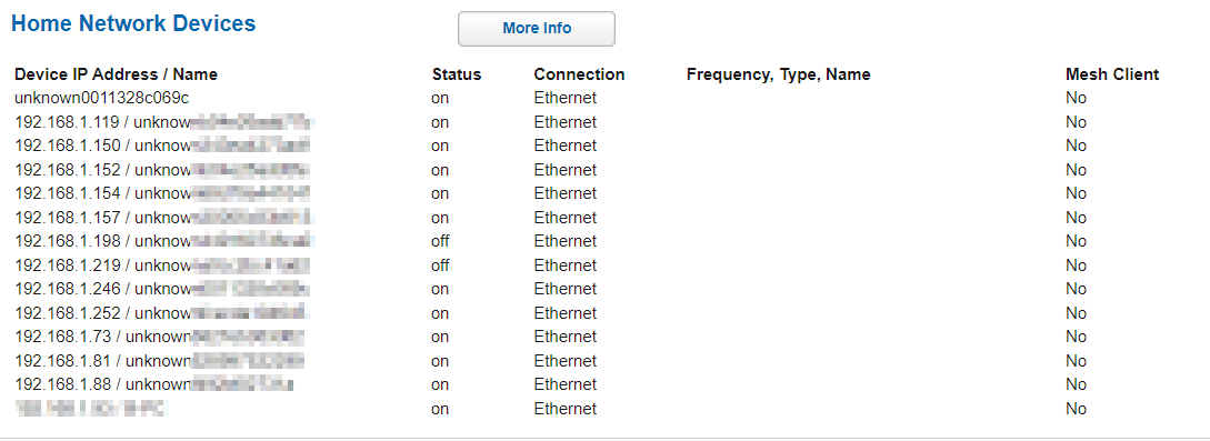

This is also seen in the ATT RG Status page:
