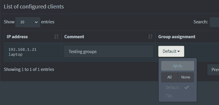

Creating groups and assigning blocklists to them is half of the job done.
By default, any client will use the Default list.
To treat a specific client differently, you first need to make that client known to Pi-hole.
So did you already add clients you want to assign non-default groups to under Group Management | Clients?
Once a client is added, you can then adjust group assignments as required:
Yes, I added the IP of my smartphone under Group Management | Clients and assigned the Group Ads_on to it - with no effect.

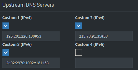

What upstream DNS servers is your Pi-hole using?
Yes, now we are getting closer I guess.
I have those defined - ads are blocked all the time:
No Upstream DNS servers on the left side.

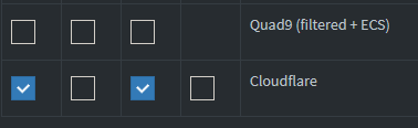

But if I check those:
or those:
all of a sudden ads appear on the clients with the group "ads_on". Don't know why that's the case and don't know if that's any good, but it seems to work.
If check "OpenDNS (ECS) ads don't appear. Don't understand anything.
Can someone explain and recommend what do check?
That's easy:
At least one of your upstream DNS servers is also filtering DNS requests.
Get rid of those DNS servers, and you should see your Pi-hole working as expected.
In fact, it likely has been alll the time.
