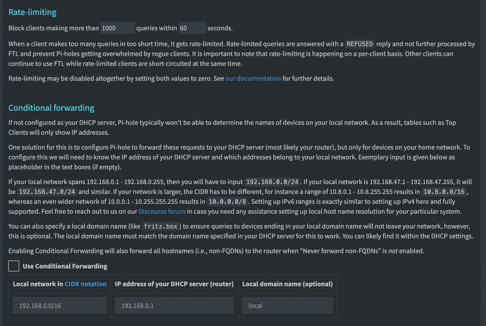

In general, a client would be rate limited when sending excessive DNS requests exceeding Pi-hole' default threshold of 1,000 requests per minute.
You'd be likely to observe that in configurations where clients use the router for DNS while the router is using Pi-hole as its upstream, aggregating DNS requests for the entire network.
However, your Pi-hole DHCP server is distributing Pi-hole as local DNS server, so your DHCP clients would talk to Pi-hole, avoiding aggregation.
You also do not have Conditional Forwarding enabled, which may have closed a partial DNS loop if your router would use Pi-hole as its upstream.
This would eliminate the two most common causes for rate limiting, leaving you to find out why your router would send excessive DNS requests at times.
