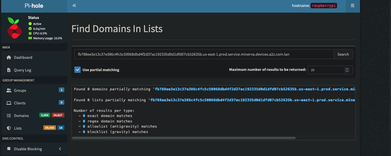

As for your original observation, let's have a look at the complete records and share:
sudo pihole-FTL sqlite3 /etc/pihole/pihole-FTL.db "SELECT * FROM queries WHERE id=22152869 OR id=22152867;"
Thank you for the feedback, do you think it would be best to just reinstall Pi.Hole and start all over again ?
redback@raspberrypi:~ $ sudo pihole-FTL sqlite3 /etc/pihole/pihole-FTL.db "SELECT * FROM queries WHERE id=22152869 OR id=22152867;"
22152867|1734487409.07489|1|4|fb788ee3e13c37e386c4fc5c50068dbd4f2d37ac192335d0d1dfd07cb52635b.us-east-1.prod.service.minerva.devices.a2z.com|10.10.10.249||517888|4|0.000557899475097656|0|517888
22152869|1734487413.06846|1|3|fb788ee3e13c37e386c4fc5c50068dbd4f2d37ac192335d0d1dfd07cb52635b.us-east-1.prod.service.minerva.devices.a2z.com.lan|10.10.10.249|||2|0.172929525375366|0|
That would rob us from analysing your issue, and I currently don't see any indication why that would be necessary.

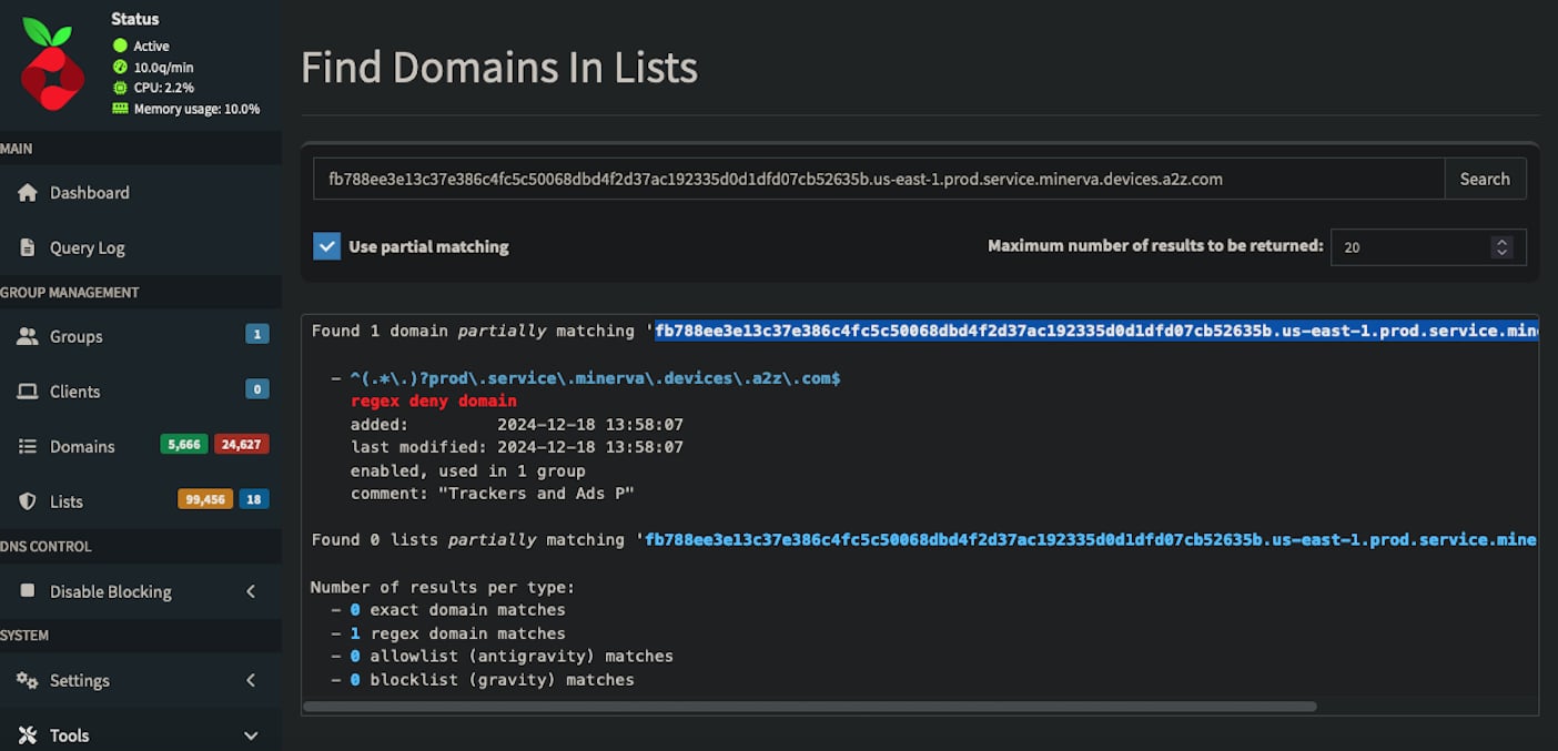

Those database results confirm your screenshots:
The query for ...a2z.com was recorded as blocked by a regex filter, apparently with id 517888.
I also noticed you are using regex excessively, I count around 21,000 regex entries.
You should note that regex evalution is computationally expensive, and such a large amount of regex may slow down DNS resolution considerably, as all of them would have to be evaluated for any domain that's not blocked.
However, your regex with that id is missing from your debug log:
 id     type  enabled  group_ids  domain                    date_added           date_modified        comment
 517887   3        1  0           ^(.*\.)?minently\.com$    2024-08-28 15:19:59  2024-08-28 15:19:59  Trackers and Ads M
 517889   3        1  0           ^(.*\.)?minewhat\.com$    2024-08-28 15:19:59  2024-08-28 15:19:59  Trackers and Ads M
Did you perhaps alter your regex before you ran the debug log?

That would depend on your blocking filter.
As your regex shown in your screenshot is matching com at the end of line, i.e. it won't match lan at the end, and thus the expanded domain won't be blocked.
As for the longer reply time for the allowed lookup:
Your large amount of regex filters may have contributed here, as all regex would have to be evaluated for allowed domains.
I am not sure whether that's actually the case here, though, as the database status column is 3, indicating the reply was sourced from Pi-hole's cache.
