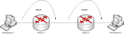

In networking though, a hop is a router. The gateway is the first hop. Consider this example:
That's 2 hops (2 routers). If I was to use your explanation, then it would be 3 hops(two routers and target device) which is incorrect.
That is but one way of looking at it.
You can interpret hop count as either the number of intermediate nodes between source and targets or as the number of node to node traversals.
I can see my poorly chosen example only lent to the confusion of that ambiguity.
I've amended it to better reflect traversals.
