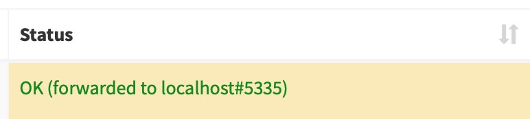

(1) In the query log you will see the following in the status column for queries not blocked by Pi-hole:

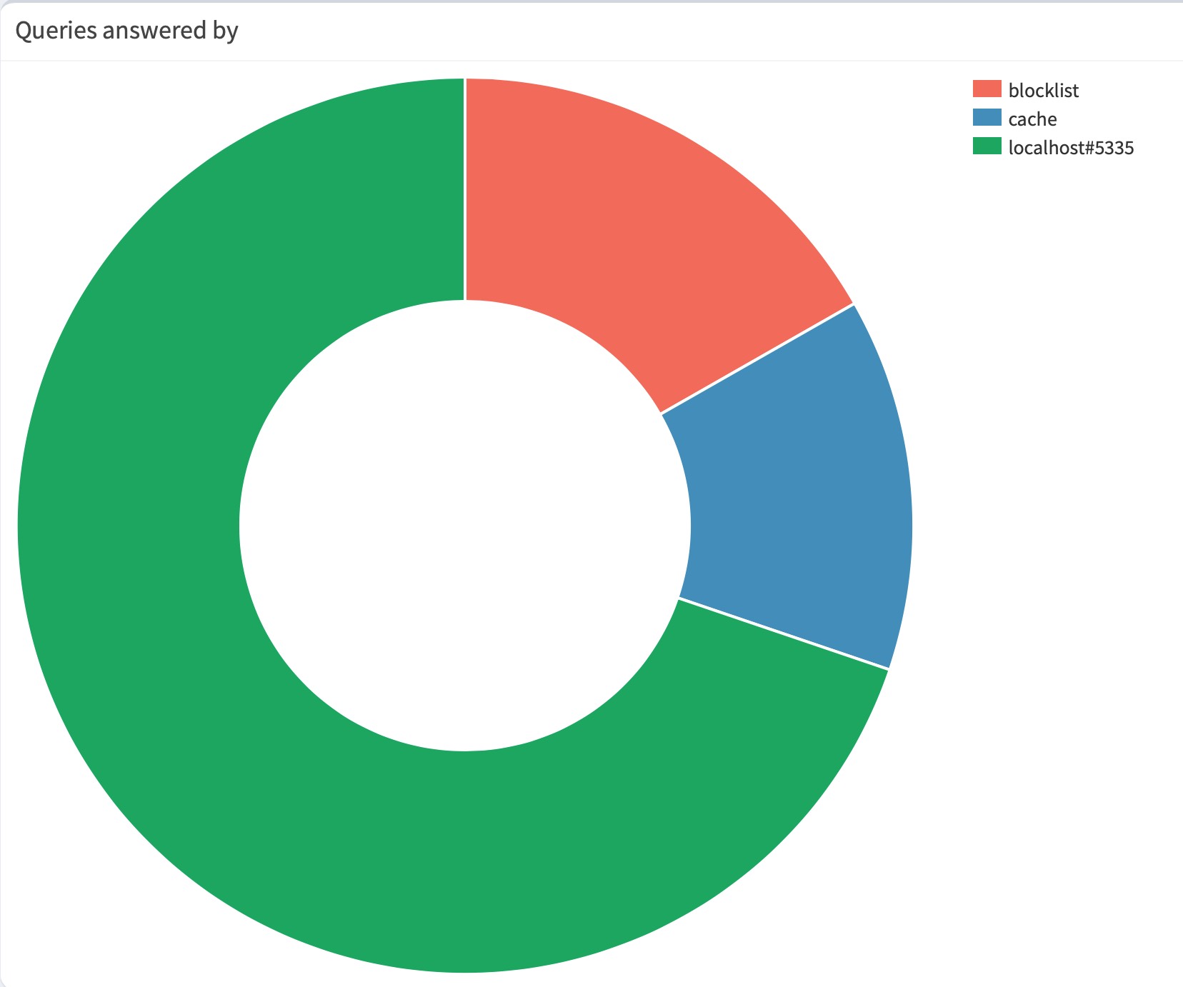

(3) After 24 hours following this change to upstream DNS resolvers, your dashboard will show the following - only one upstream server and it will be localhost on the port you specified:
This is the DNS nameserver being used by the Pi, not the upstream DNS being used by Pi-hole. These are two different things.
