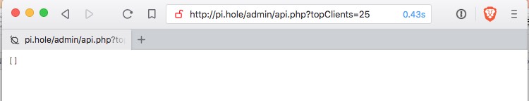

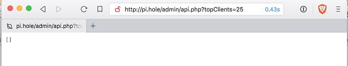

Do http://pi.hole/admin/api.php?topClients=25 and http://pi.hole/admin/api.php?topItems=25 give you more than 10 results?
It does not. On Safari and Brave (both on Mac), I see this:
You need to be logged into Pi-hole's dashboard in the same browser to have the permissions to request these data.

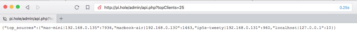

I get more than 10 in both
When your system knows only 4 clients, there is no chance that the table can show more than 10 :wink:
Oops, wrong Pi-Hole. :frowning:The other one with 20 clients shows a similar list, with all 20.
