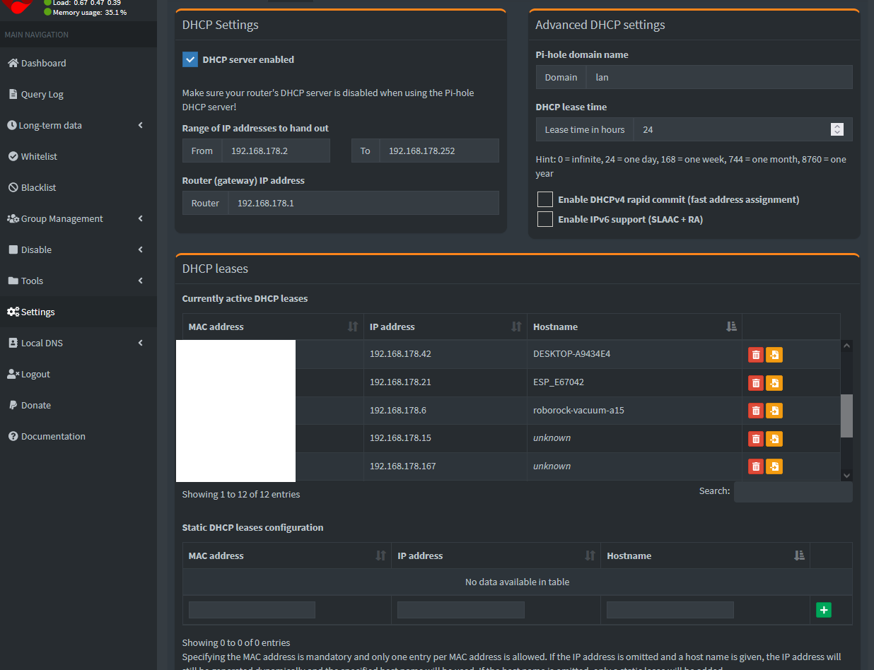

I use pihole as a dhcp server. But some devices don't have hostnames, see this picture:

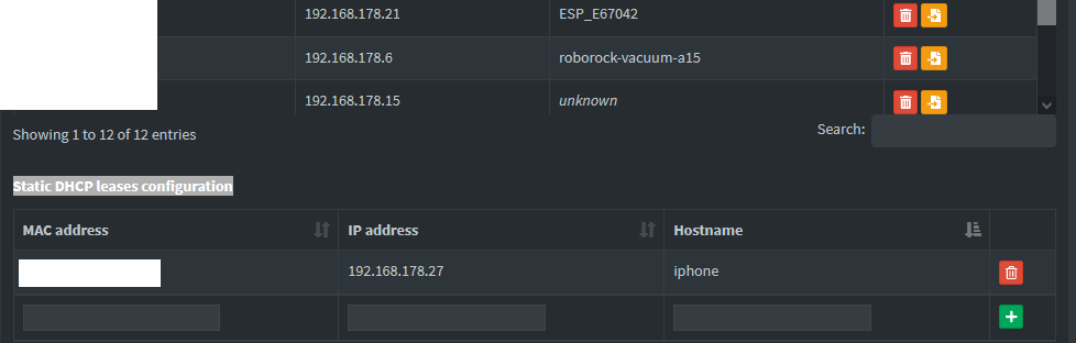

Any chance to change the hostname by my own? Like replacing 'unknown' with 'iphone'. I already tried this with the Static DHCP leases configuration section:
But if i take a quick look in my query log, my device is still recognized in the Client column with the ip address 192.168.178.27 and not iphone:

So I waited some days: The mac address of my iphone didn't change (also, I've got a dhcp lease of 24 hours). This is not the problem, I guess. I changed the hostname in Static DHCP leases configuration and this works. What would be the difference between using Static DHCP leases configuration or DNS Records in this specific case?
