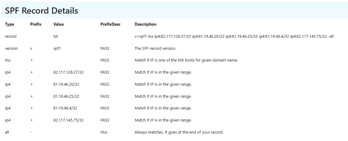

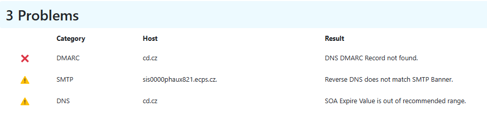

I checked that domain in Domain DNS Health Checker - Check DNS, Blacklist, Email, MX Health (dnschecker.org)
and there are some issues with that domain name...
So the problem is not in my Pi-Hole, it is not in unbound, it is not in my network...
But it is on the side of root DNS serve ???
Or the problem is in my ISP network ??
Or the problem is somwhere else ?
That may contribute to your issue, but if it was just that, then you, me and every one else with a similar setup would experience the same - but that's not the case.
That would suggest the issue is specific to something in your DNS resolution chain, caused by either something in your network or on the route from your ISP to the authoritative DNS servers.
