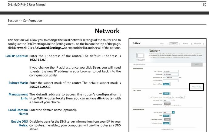

Trying to upload a picture of how I use my pihole as DNS through my router:
EDIT:
I now changed back my router settings to 1.1.1.1 and manually changed on my phone and PC to use 192.168.0.125 as DNS and it seems to work? When browsing I see querier + queries blocked gradually go up. Maybe the settings I did in the router was wrong? I thought what I did was to make the router give out my Pi-hole DNS to all devices connected.
You are probably correct in assuming this. From the image posted, you put the correct DNS info in the WAN section instead of the LAN. Try looking to see if there is a LAN section and input your Pi-hole IP as the primary DNS server.
I can't find how to do this in my router...
I have a D-link and this.
DIR-842 HW:B1 FW:2.02
When routing my devices manually to my Pi-hole (192.168.0.125) it now seems to work good.
Thanks all for the replies.
It should be in your manual.at support.dlink.com. Take a look at page 51 network section. Leave the DNS relay enable and check out the advance settings and see if it allows you to input your pihole DNS.
