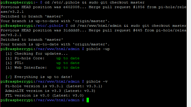

The result:
Really appreciate this community, thanks!
