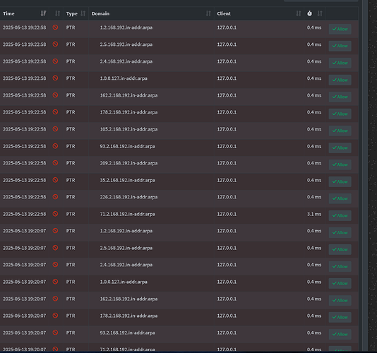

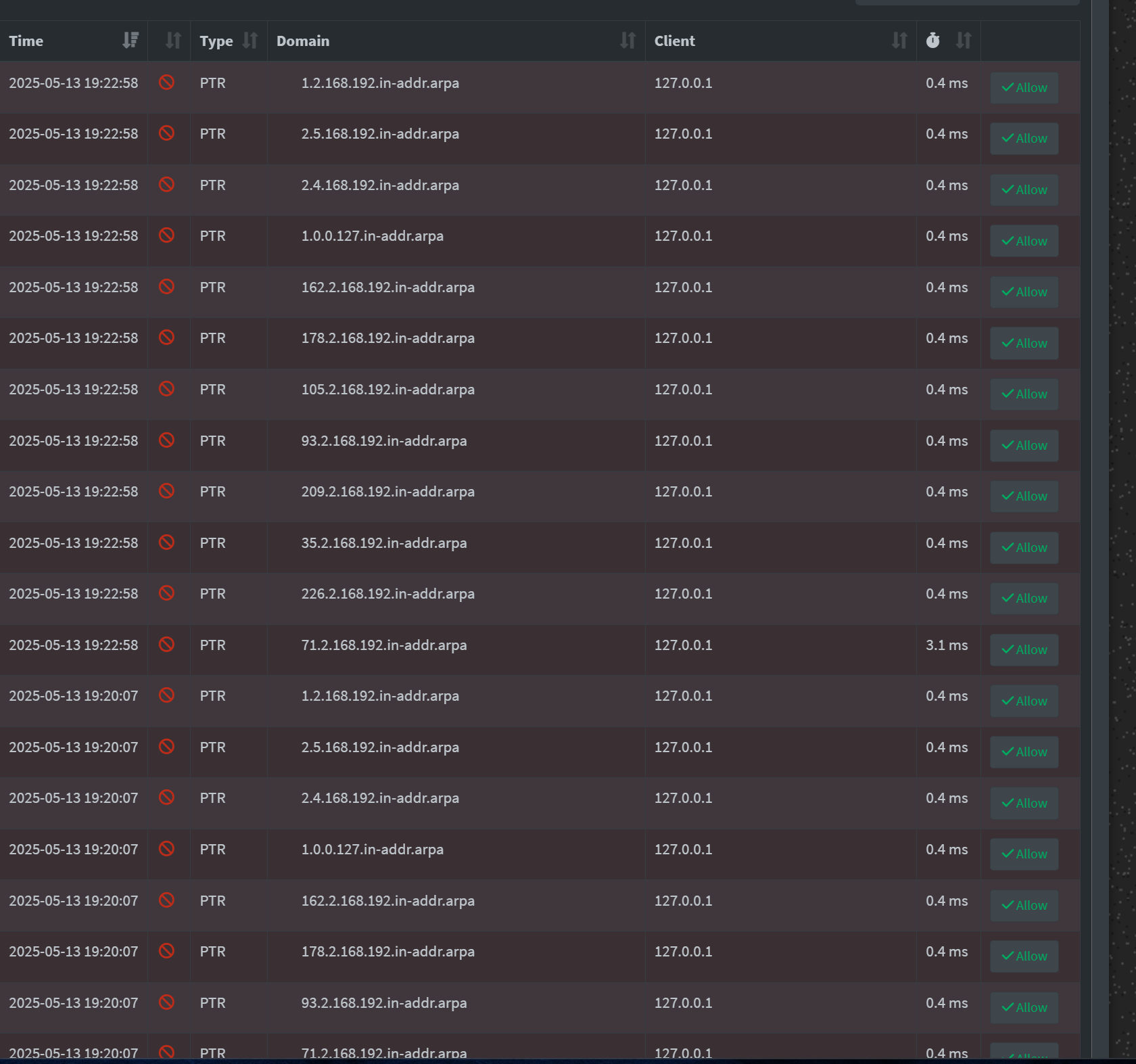

I also noticed that pihole seems to block traffic from 127.0.0.1 as well as my other subnets. I don't know if that's normal or if it started happening after the upgrade. See attached screen shot.

But your screenshots already show that PTR requests are blocked by Pi-hole.
Apparently, you've configured a regex rule with id 99, labeled as TLDs to block arpa requests, effectly denying all reverse lookup resolution, including public ones.
At the same time, you've only added a single rule to allow 192.168.1.0/24 lookups ^.*\.1\.168\.192\.in\-addr\.arpa$, with id 91 and label ARPA Local.
In order for PTR reverse lookups to succeed again (not just your local ones), you should remove arpa from your blocklist.

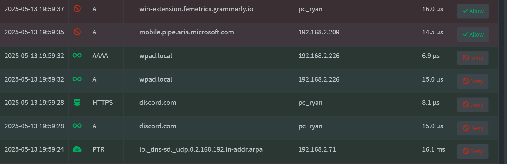

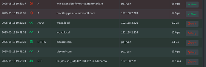

On the windows box (192.168.1.50) nslookup can't lookup the aliases:
> simba
Server:  pi.hole
Address:  192.168.5.2
*** pi.hole can't find simba: Non-existent domain
> pc_ian
Server:  pi.hole
*** pi.hole can't find pc_ian: Non-existent domain

How do they register in Pi-hole's Query Log?
Thanks for having me look at the query log. Figured out that the .local was sticking despite /flushdns and /release /renew and a nbtstat /R. Once I rebooted, .lan took to the Windows device and that resolved that issue. I removed AARP instead of ARPA, that was indeed blocking nslookup for public IPs. - Still don't know why my old configuration was working on version 5.

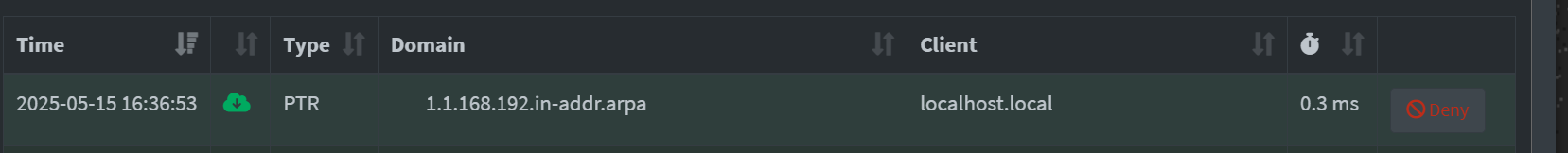

I see a potential issue with the localhost. When I "Expand hostnames" in DNS, I see this:
It adds the .local -- when I turn on enable "Expand hostnames" in the Pi-hole DNS settings. When I turn it off it removes the .local
I just want to double check that isn't an issue. I've set the domain to .lan on the UDM SE gateway (192.168.1.1). The domain is set to "none" on pi-hole (192.168.5.2).

That isn't the case.
Your debug log shows your Pi-hole's domain name as local (accessible via Settings|DNS :
domain = "local" ### CHANGED, default = "lan"
Just got back from a week long vacation. You are absolutely right. Fixed the domain on Pi-hole and DNS is returning as expected. I seriously appreciate your help in resolving these issues. I really felt it was hopeless at first. Looks like we have smooth sailing once again. Best wishes!
