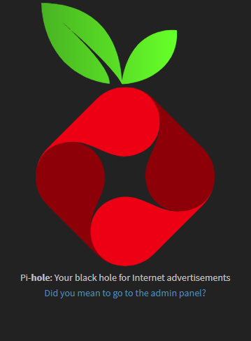

Now, when i try to connect ip-address-of-rpi/dump1090/gmap.html,
i see this:
What i need to do to reach that site successfully as before?
Not sure what FlightRadar24 is running as it's web server but most likely, lighttpd, a requirement of Pi-hole, took over and replaced that.
Which is weird, because it should have failed at starting the service, since there should have been something there, serving the FlightRadar24 data, on port 80.
