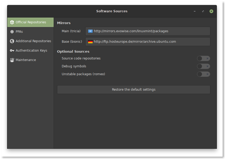

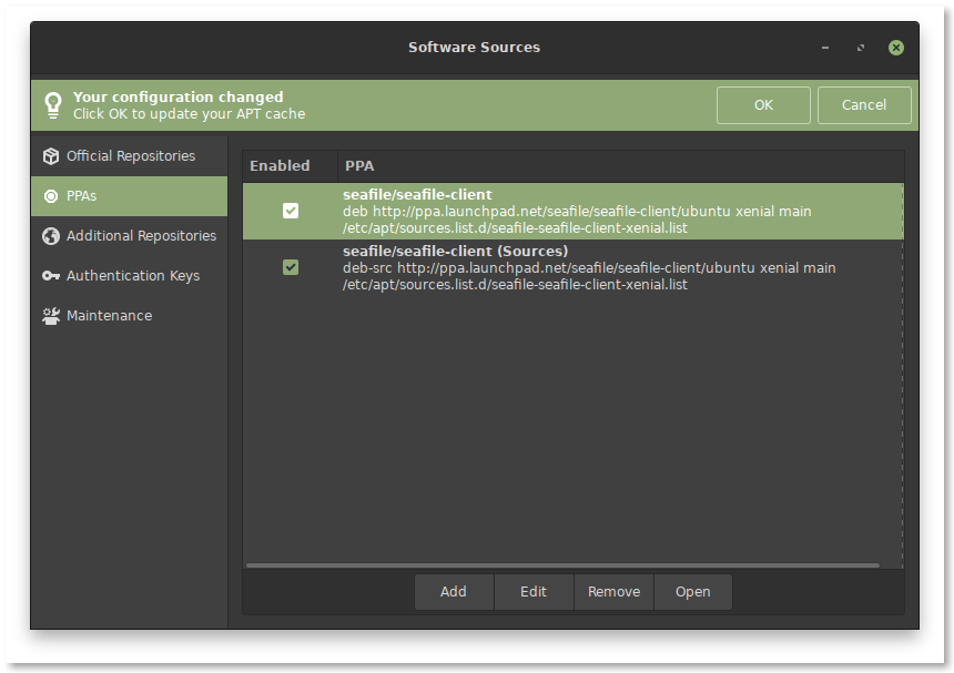

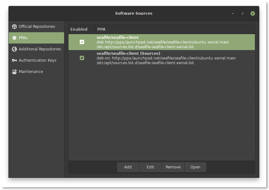

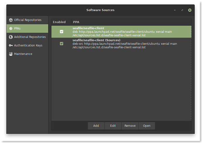

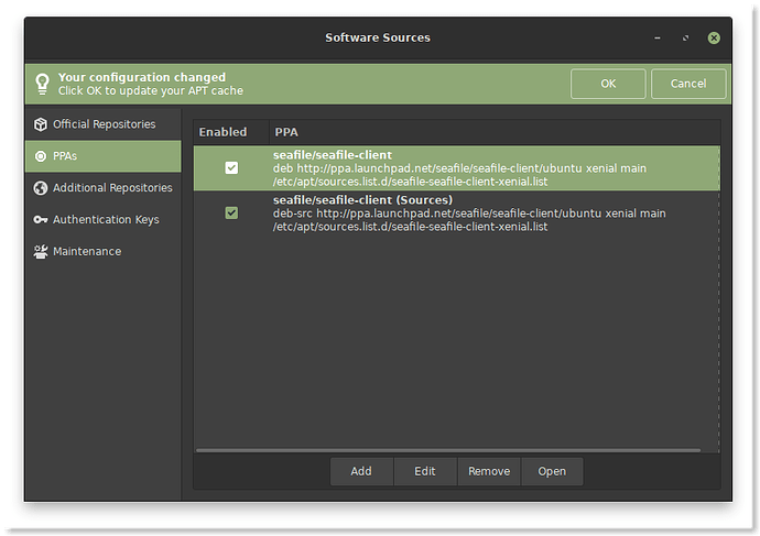

Not knowing which version of Linux Mint you have, I will recommend how to solve this based on the most recent one:
  1. Go to "Software Sources"
  2. Open the tab "PPAs"
  3. Uncheck the rclone-browser and also the dl.google one and agree to update your cache
Try to update your system to the most recent version using the usual update manager before trying to continue. If you cannot find something, show us a screenshot of where you're stuck and we will help you from there on. If something looks different, just tell us what. We're here.
