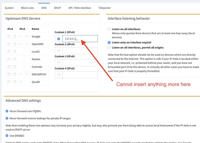

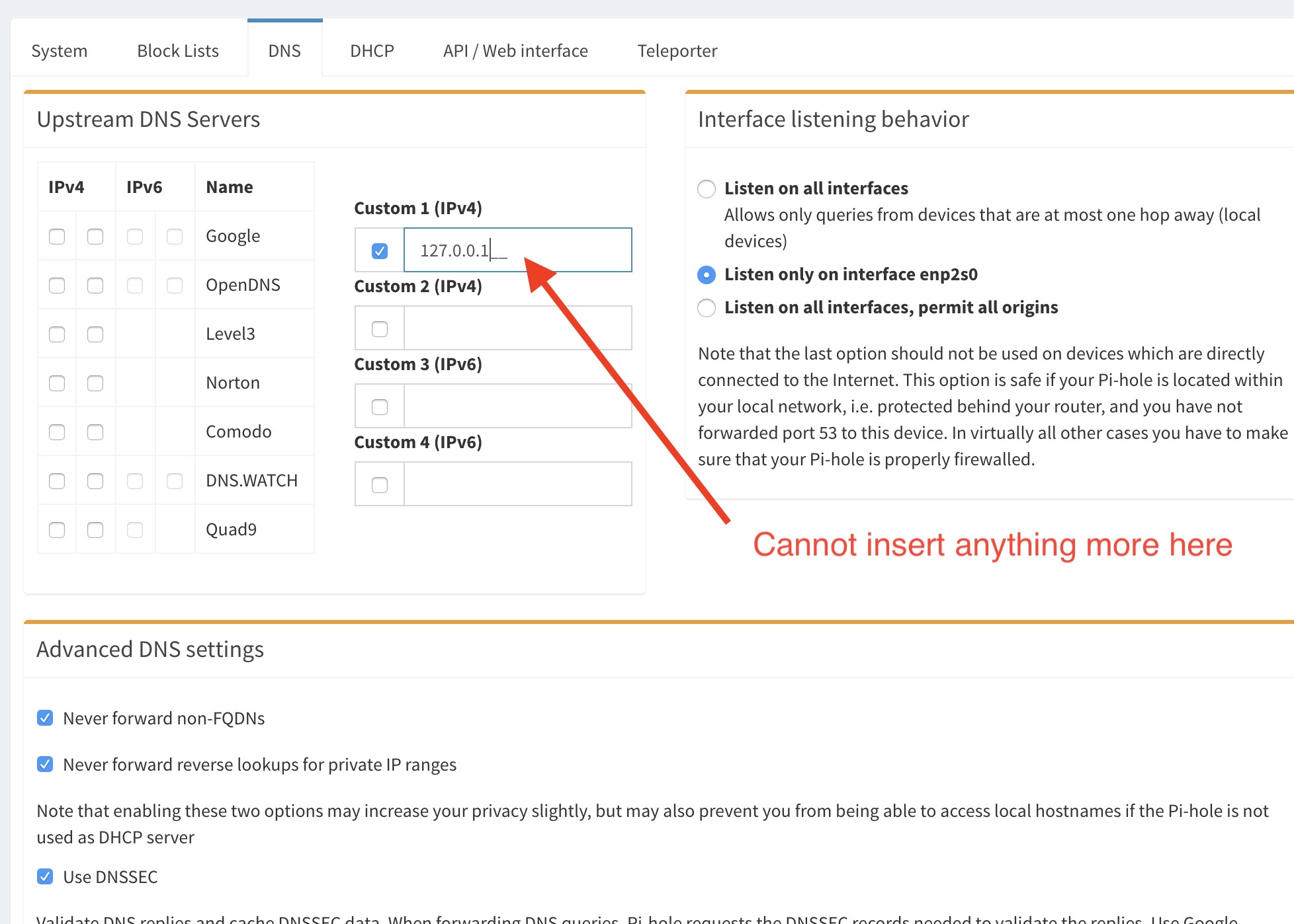

Can't insert Port into DNS Setting Page
i am new and just following this FAQ: Redirecting... and somehow, this #5353 Port i can't insert it in the custom Field. It wont let me. Did i missed something?
Do i have to install cloudflare before?
My aim (not sure if i understand it correct) I want to Use Pi Hole with Unbound and Cloudflare.
I did not made any changes with "FTLDNS" (do i have to configure this too?)

Yes, you're not on the beta. You need to be on the beta first.
thank you. I joined beta.

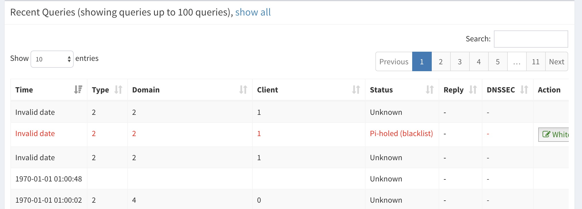

But the Query Log shows a Browser Error:
DataTables warning: table id=all-queries - Requested unknown parameter '4' for row 42, column 4. For more information about this error, please see http://datatables.net/tn/4

You can try to fix this by clearing your browser cache.
thanks, found a Article on that, but this wont help.
Tried twice.
Have you checkout out all FTLDNS branches as described on the blog? It won't work if you checkout FTLDNS only partially. Use the provided instructions:
echo "FTLDNS" | sudo tee /etc/pihole/ftlbranch
pihole checkout core FTLDNS
pihole checkout web FTLDNS
i ran this two (three) commands.
and checkout, of course.

Perhaps try checking out development:
pihole checkout dev
