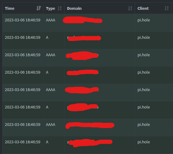

Could you share a screenshot of the dashboard and the query log highlighting your issue?
.+ all domains in the top domain list are from localhost/pi.hole. I don't want to see domains from localhost on the dashboard + query log.

That's only the query log - the dashboard would have been helpul, too.
But not seeing any localhost entries, it would seem that IGNORE_LOCALHOST is working.
If you wouldn't want to see pi.hole as well, you could consider Dan's suggestion.

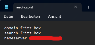

this is my file, the censored one is the pihole-ip that resets after a reboot..

Commonly, the tool governing changes to `resolv.conf` would write some respective information to that file.
Here are some examples
# Generated by NetworkManager
search fritz.box
nameserver 127.0.0.1
# Generated by resolvconf
domain fritz.box
As that is missing, I cannot know what network management tool your system would be using. You'd have to consult your OS documentation and support for details.
It would depend on your Linux distro, possibly its release and its configured network management tool how you'd go about persisting your changes to your system's DNS resolver.
You state you are running Debian, which may mean that you've opted for a certain set of networking packages when building your system. Remembering those may serve as a starting point for your search.
