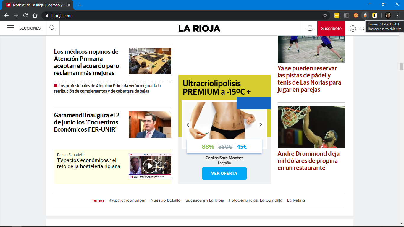

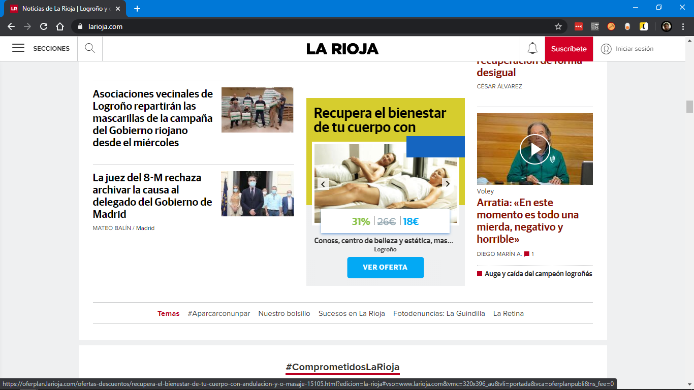

I've tried adding the domain to the blacklist, but nothing.. this must be something stronger...
The ad is the one in the middle in this page:
The domain that I see linked to it is oferplan.larioja.com
But even though I've placed the domain in the blacklist, it insists on showing up.. ideas?
Thanks! Tried a few and figured out one thing... this particular ad is a carrousel... it's inside a container! ugh...

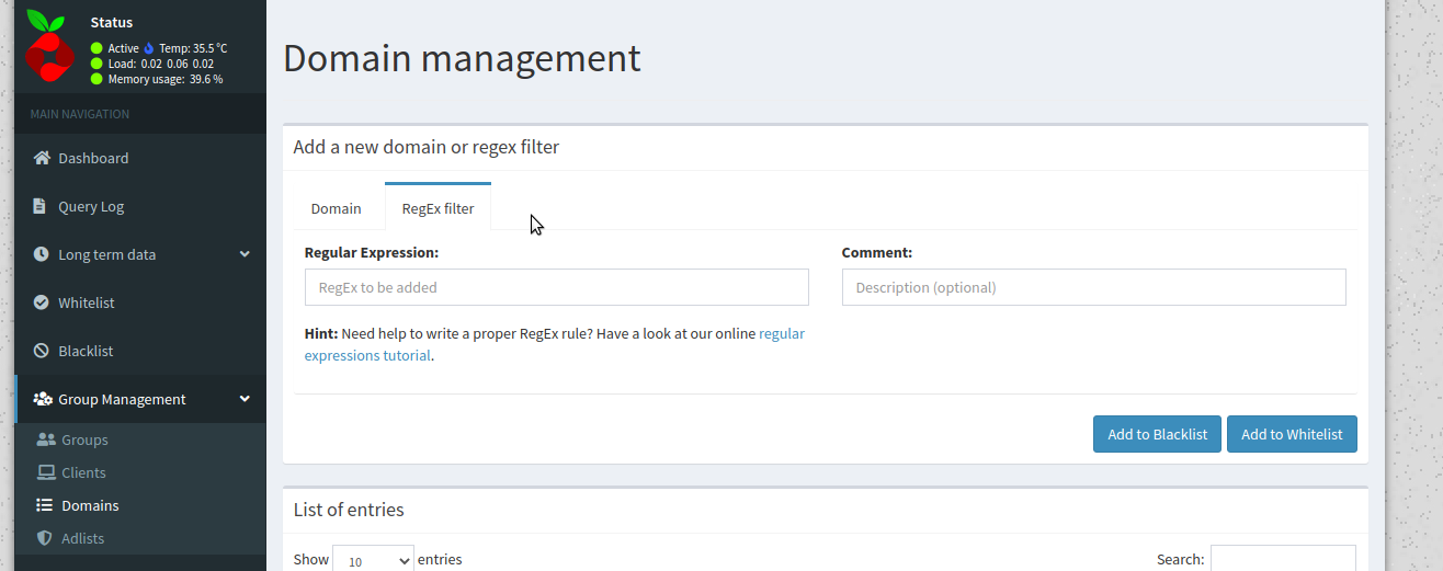

With the stock blocklists and a few extra regex, I don't see what you see:
How do I set those up?

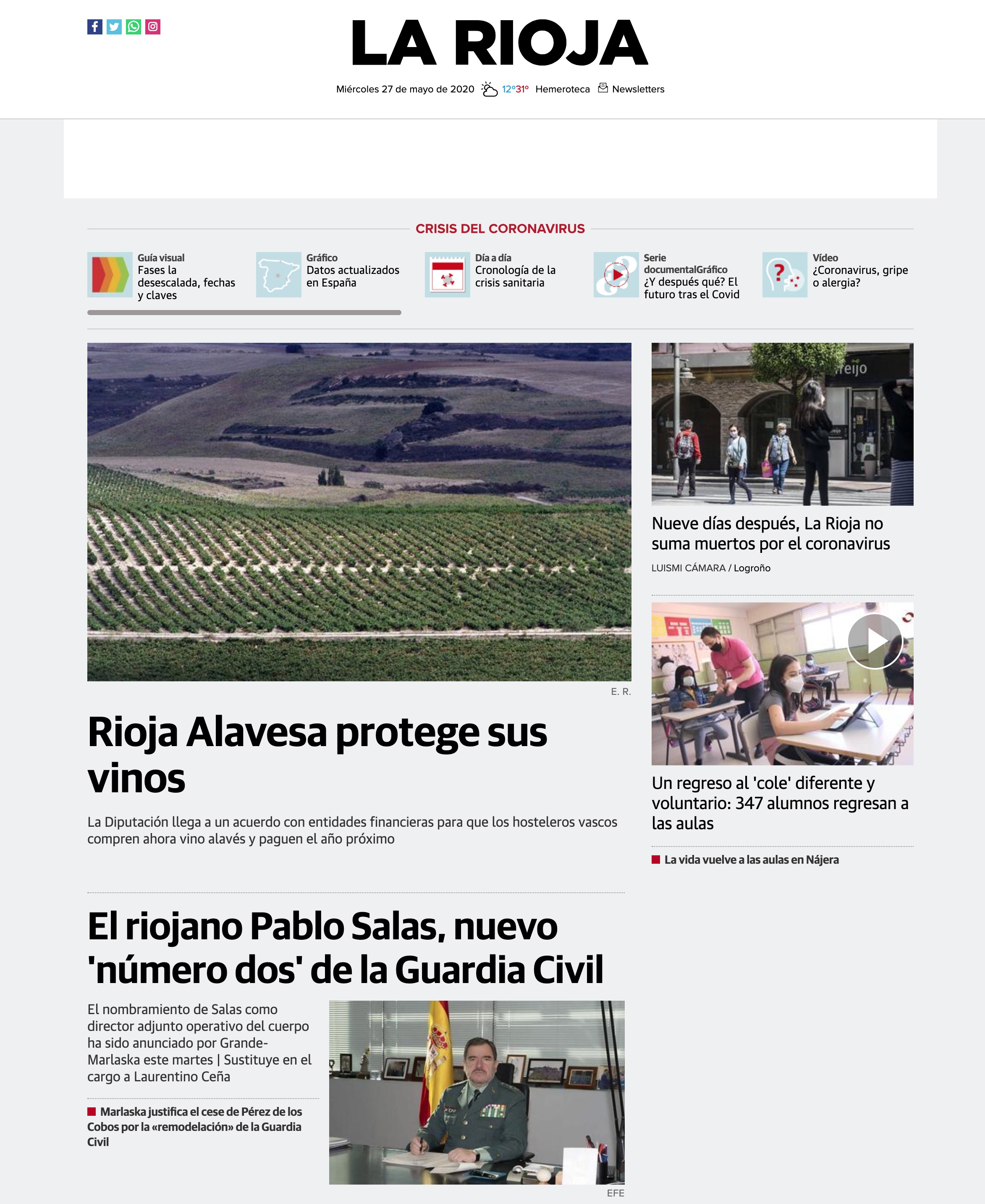

The ad is lower down the page.... Right after the opinion row....

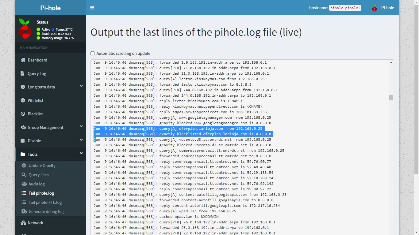

Darn.. I found the culprit being caught in the logs...

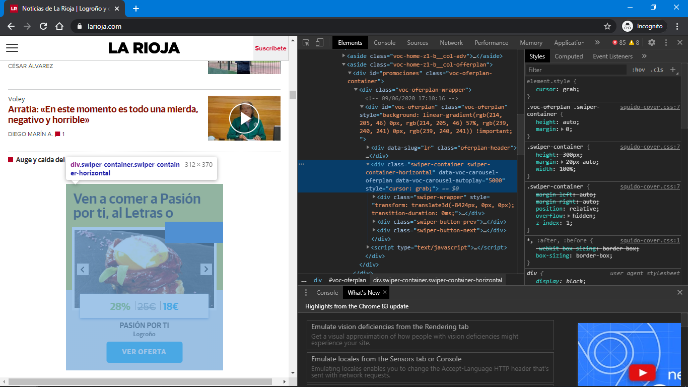

But still the darned ad appears (that yellow-ish/green-ish blob in the middle):

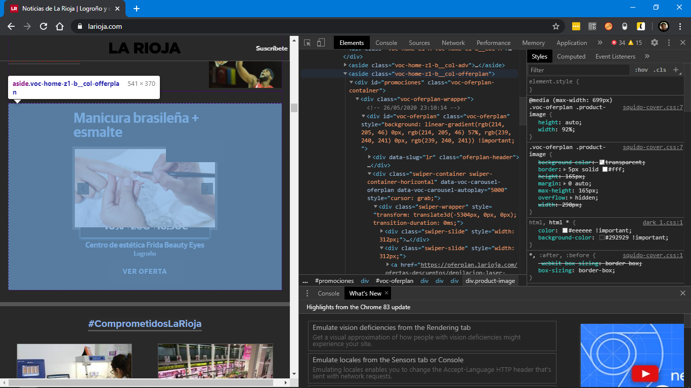

And looking in the code I found this:
