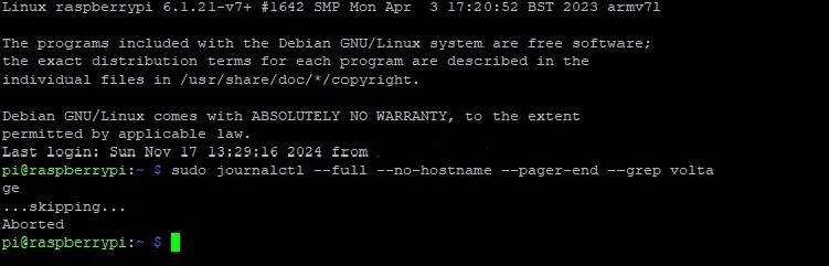

Also consider below which is more likely:
Does "Aborted" count as a warning?
Sort of :wink:
It says its "skipping" which is coud be an indication that the journal logs are corrupted too (it tries to skip over the corrupted bits).
