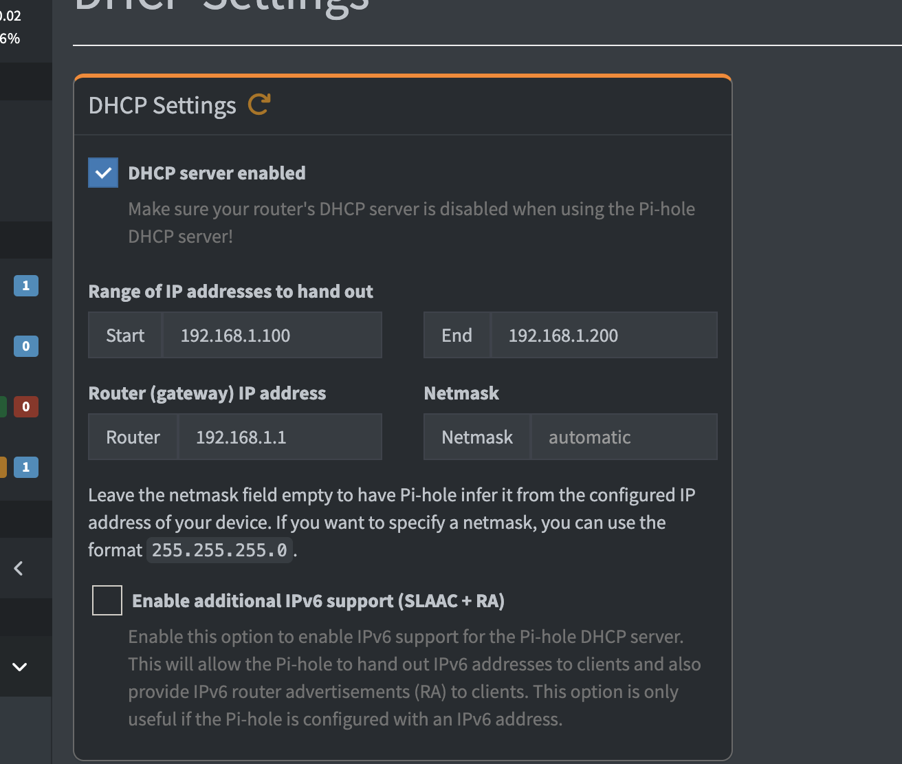

What I did:
  1. I installed Pi-hole software on my raspberry PI successfully, no issues.
  2. On my home router I assigned my raspberry PI a static IP: 192.168.1.2
  3. On Pi-hole interface I enabled DHCP server to handle IP addresses: from 192.168.1.100 to 192.168.1.200. (raspberry PI address is outside this range!).
  4. I restarted everything
  5. I expected that now all devices will get an IP address from range that I set and ads are blocked

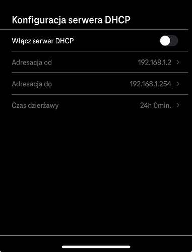

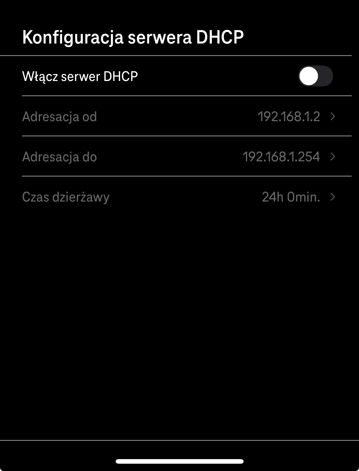

(It’s in Polish, I couldn’t change the language of this silly app, basically first toggle turns off DHCP server)
