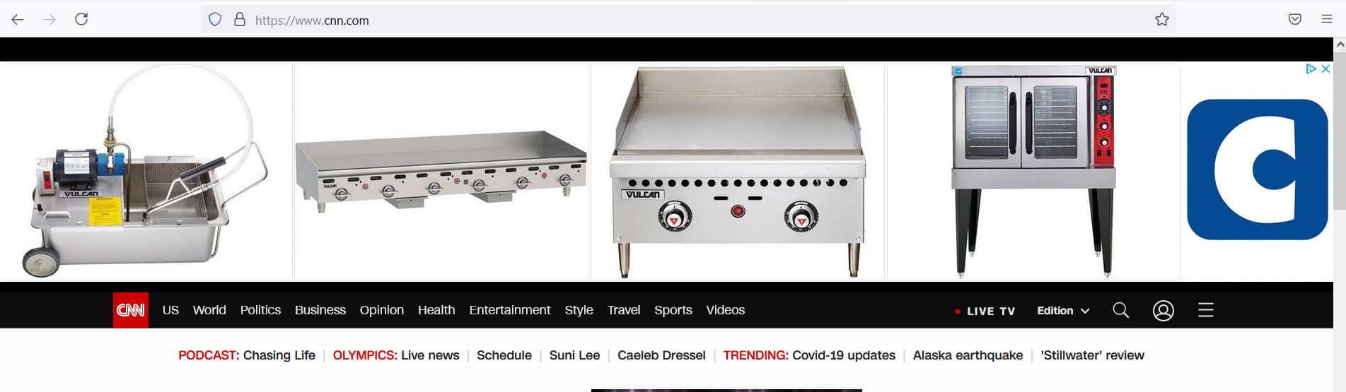

Yet, I get this when I load CNN.com:
Which links to googleadservices.com. It's not just CNN either. But when I disabled IPV6 on my laptop it stops. Okay, no biggie. I could just do that. However, my spouse's Samsung tablet doesn't let you disable IPV6, so it's ad city on that. And there are other devices in the house that I'd have to run around trying to disable IPV6 on. I just don't get how these ads are getting through.
Intermittently, but ultimately it shows Pi-hole returns the domain as blocked:
Your observation may have been coincidental - there are no indications that IPv6 would be your issue.
