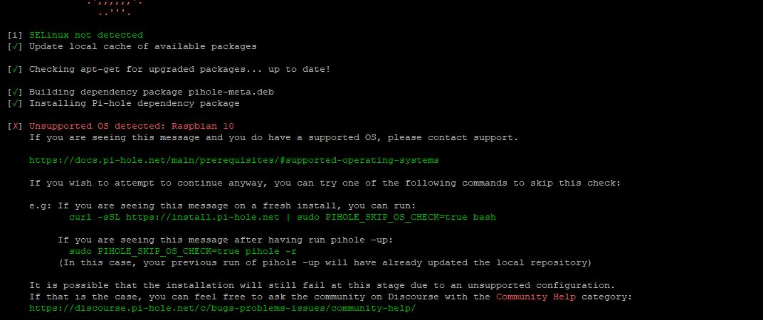

Run the following command and see if this gets you fully on to V6:
sudo PIHOLE_SKIP_OS_CHECK=true pihole -r
Long term, you will need to upgrade your OS to the latest release. If you have problems with the repair, then a fresh install of a new OS and clean install of Pi-hole may be your best path.
Hi this is what appeared after entering the command
