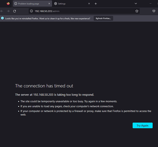

Cannot access the web interface after initial pihole install and setup

Did you try to access the web interface using a different device?

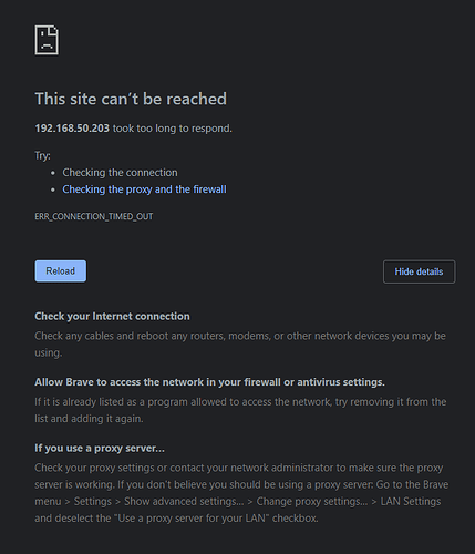

I did. Tried it on the Ubuntu machine, my personal computer running windows, both of which are wired. Then I tried on my cell phone's browser.
It gets the furthest on my cell. It will warn that the site isn't secure and then when I click proceed, it gets stuck loading while still showing that warning message.
Are these all using the Brave browser? It has a couple of features that bounce http over to https and they may be interfering. To test this you can try to disable it (or try a different browser to see if it behaves differently).

I have tried Brave, Edge, and Chrome.
The HTTPS only mode is not enabled on any of the browsers.
I just tried mozilla on the ubuntu machine and I can now get to the login/admin page. Will try again on my main machine after I clear and restore settings within the browsers.
Still no go on my main machine when trying to use Edge, Chrome, or Brave.
Edit: Just installed mozilla on my machine - still no go
