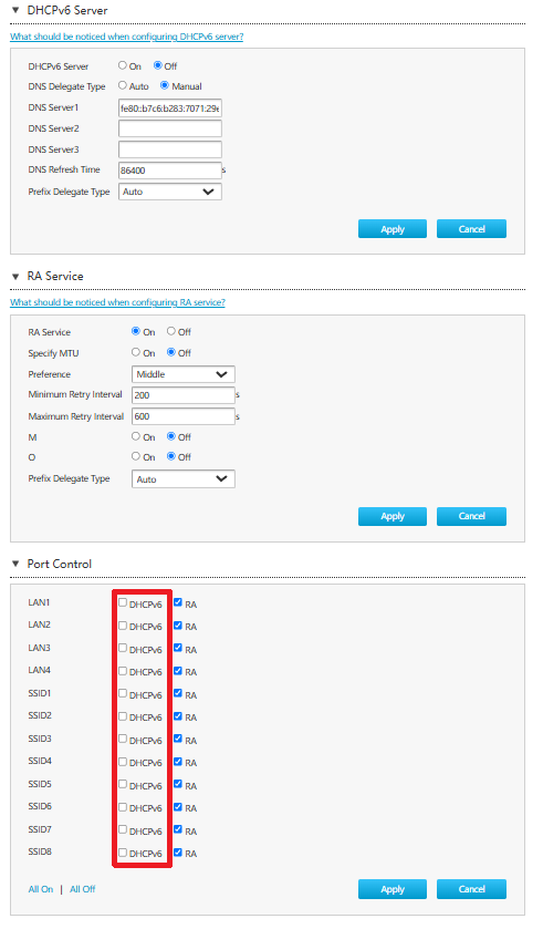

However, if I am not connected to the VPN and I enter the local DNS like: "mydomain.test" it tells me that the IP address does not exist. If I enter the IPv4 of the Raspberry it says that a firewall may be blocking the connection (Chrome shows this message). If I connect to the VPN instead, everything works. Unbound and wireguard work perfectly. I do not understand. I also disabled this control in the router, couldn't this be the problem?

Thanks for the reply, I'm actually really stupid. Yes, the solution is more or less what you said, but I didn't see that the option in the VPN settings was enabled on the phone: "Block traffic if not connected to VPN." by turning that feature off, I was able to access the dashboard. I wanted to delete the post from yesterday but I couldn't do it, thank you very much!
