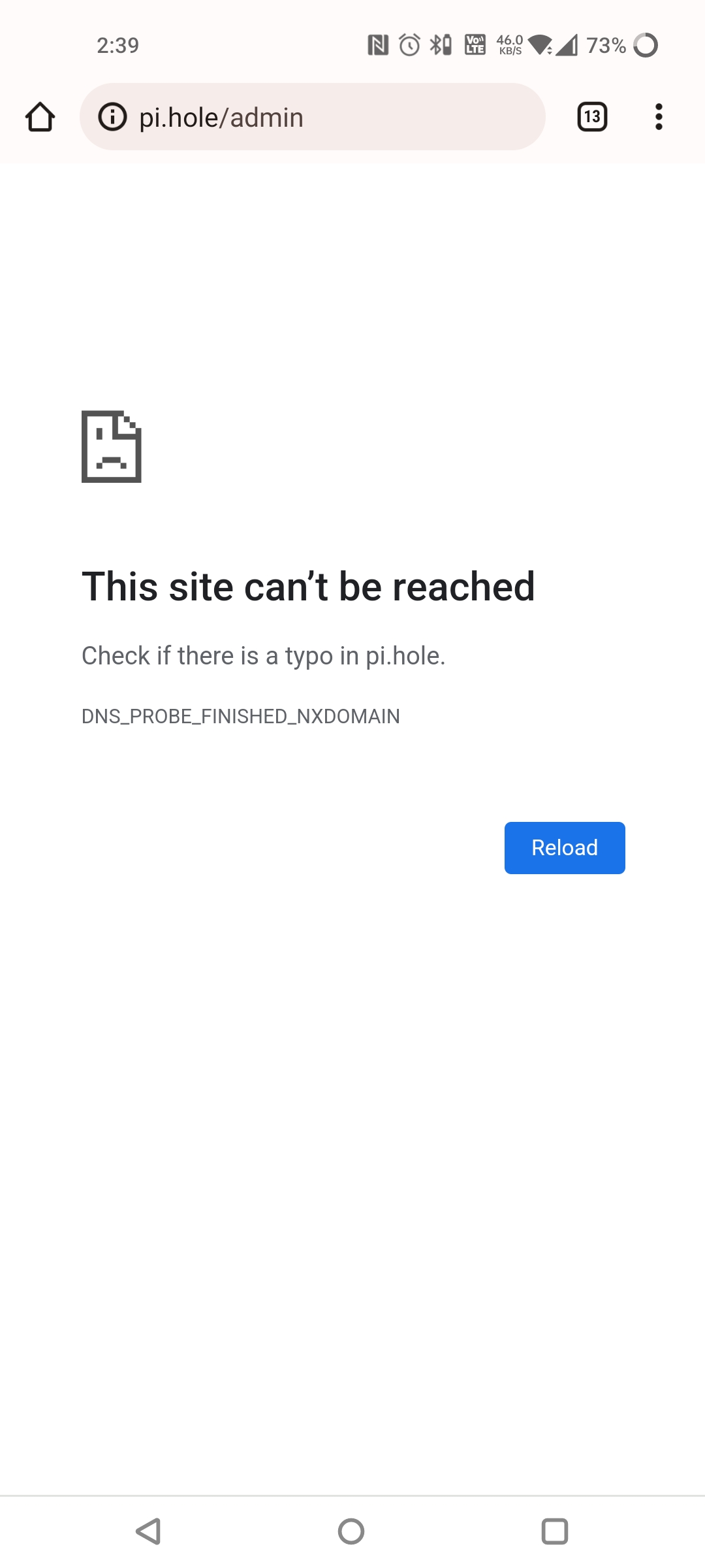

The issue I am facing:
Cant get to the pi-hole dashboard
Details about my system:
Can't use my phone or my laptop, i try clearing out catch & cookies both devices
I updated pi hole and still can't access it.
Before noticing i couldn't get to into Pi-hole dashboard was after updating firmware on my wifi router.
If anyone can please help me, I would appreciate it.
Try to access the Pi-hole via IP address instead of pi.hole, probably the devices do not use Pi-hole as DNS resolver currently (then pi.hole is not resolved) , which then would need to be investigated as well.
I don't know the ip address anymore. Is there way to find out?
E.g. in your router as connected device or where you configured it as DNS server for clients. Otherwise with an IP scanner.
Think i find from my WiFi router,"192.168.50.126" and when i enter & apply back to the DNS. everything is working again. YAY!
