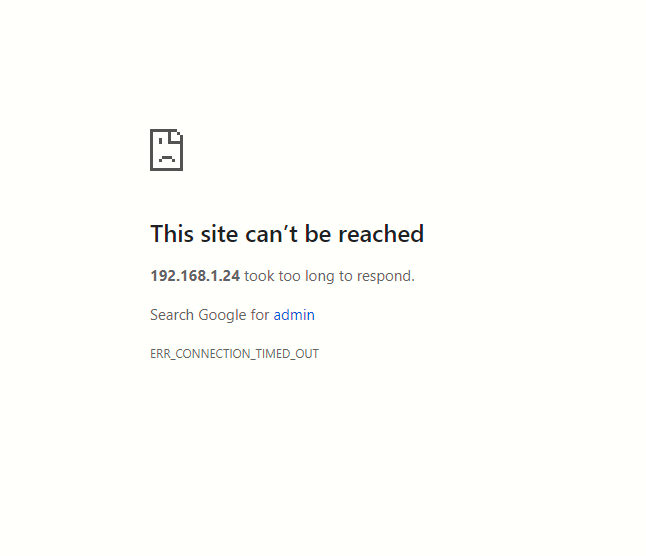

I cant access the admin panel on any other device including the host pc for the pi-hole VM. I check on the actual vm using curl -i http://192.168.1.24/admin and it came out with a bunch of html code

Maybe its how im doing it router wise? i set this up image but im not sure if its using this?? Im not too good with routers and stuff
I have it as
IP address: 192.168.1.24/24
Gateway: 10.0.2.2
and this is what i get when i try and connect
192.168.1.24/24 is a different network than 10.0.0.0/16. If you want to have the networks segregated like that then you'll need a router or something at the gateway to handle moving packets between the two networks.
How should i have my DNS then if i want to keep the ip?
Easiest would be to have the DNS IP in the same network subnet as the clients.
Alright i changed my stuff to
Gateway: 192.168.1.1

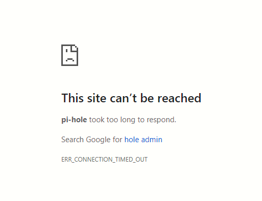

and its definitely working on my devices, but I still cant access the admin panel, any ideas on why? It keeps saying ERR_ADDRESS_UNREACHABLE for http://192.168.1.24/admin and
for http://pi-hole/admin
Alright just got the admin page to work, but now when i try and connect to dns 192.168.1.1, it says in query log that nothing is there expect for localhost.
That's not the correct URL.
The default URL to use would be http://pi.hole, but from your posts, it would seem that you'd have to figure out how to correctly integrating the VM you are running Pi-hole on (whatever that may be) into your network.
That would be specific to your VM and host OS, rather than Pi-hole.
